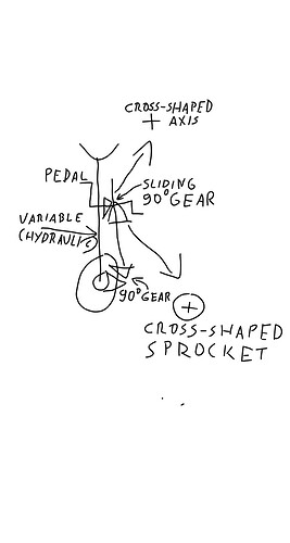

Instead of a chain I would try it with a cross-shaped axis and a sliding gear on it.
