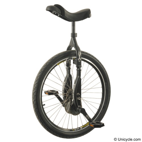

has anyone bought one of these unicycles?
now there is a price drop from £495 to £180 im very tempted
http://www.youtube.com/user/HuniRexUnicycles
I think the main issue was hpedal strikes-rex. :wink:
In theory they sound decent for commuting/city riding… Fast as (Faster? I dunno what they gear up to) a 36er, but small/carryable as a 26er… Pedal striking sounds like a pain but if you’re only riding it on the road anyway, what’re you going to strike? :smiley:
Sadly I’ve never really found any real information on these things. They look cool, though I wonder if the cranks can become mis-aligned as they’re not attached to each other…
wow… i thought they dropped to that price to be discontinued.
I’ve had a ride on a huni and it is a weird beast and a pig to mount. Imagine riding only in top gear on a schlumpf but unlike on a GUni, you are stuck with a 39er wheel the whole time and the rollover ability of a 26. The crank position feels a little weird but can be got used to. Due to the gear up, the wheelset feels ~50+% heavier than it really is.
Pedal strikes were not a huge issue for me as it turns like a oil tanker.
What it does do is GUni or 36er speed on the cheap in a smaller package. Most of my dislikes of this could be worked through by a determined rider and the reward offered of scalping b*kes on the morning commute is sometimes too good to miss. If you are planning on buying this, put a foss tube in it and maybe even find the lightest tyre that feels ok, it should make it more manouverable.

well…
165mm cranks = 5.5"
~4" from hub to crank axles
18" hub to top of wheel
6+" for top of frame and saddle
Looks like it needs a minimum inseam of 32.5+ With some modification, maybe a 30" inseam would be possible.
On the other hand the frame looks like it could take a 700c wheel to make a monster race unicycle without modification. Another easy change would be to swap out the drive sprockets to give a different gear ratio.

I was riding Huni-rex at EUC some years ago and I did not like it. It felt really strange and sluggish and pedal strikes happened often on a track that was set up due to tight turn. Also cranks were going out of sync sometimes, but it was easy to tighten and resync them.
But…
first, there were some changes to the construction later and I’ve heard cranks going out of sync is not a problem anymore (or at least not that often).
second, I was riding it before trying guni, so I was not used to riding in high gear. It would probably feel much more natural for me now.
third, the original price was way too high for such limited application. But the 180 pounds sounds like a fair price.
fourth, I like the idea of having it 700c’ed. This could be a nice uni for commuting.
Or you could buy the Nimbus 29er with 89mm cranks. It’s 1kg lighter, has a narrower frame and less risk of pedal strike.
The Huni-rex has some novelty value though. If I was a collector of unicycles then I would snap one up fast at that price.
Cranks going out of sync sounds terrifying, even if it only happens ‘not that often’. That to me is enough to say I don’t think I’ll bother :smiley:
I am still vaguely interested to hear how fast a 700c version could go though.
the cranks should not go out of sync as long as the hub is fitted correctly.
