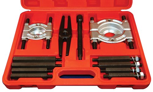

Those things look awesome. Whether I end up using them on this particular project or not, I am definitely getting a pair or two. Right now the only thing I have that beats brute force is a bearing separator/puller kit like this one. Probably not the best tool for this challenge.
