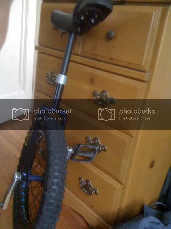

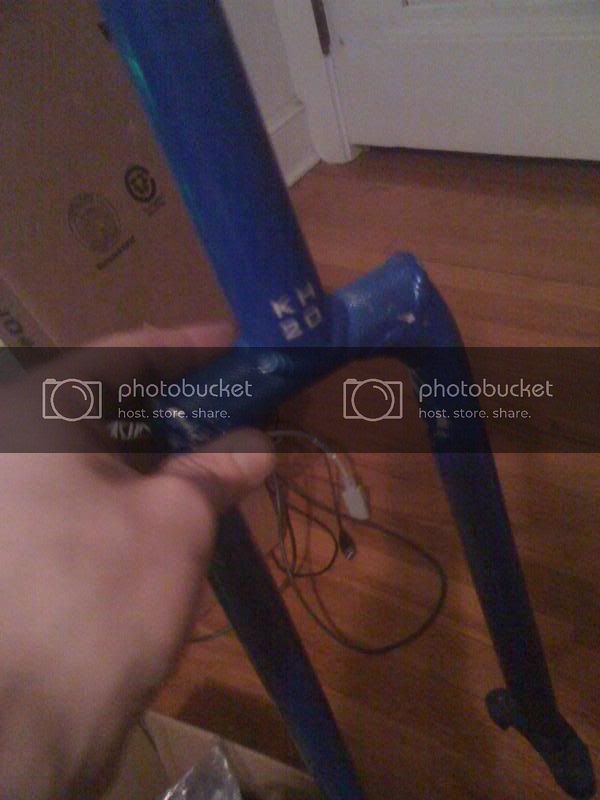

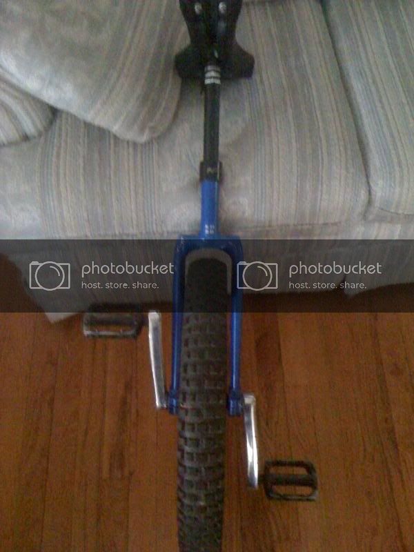

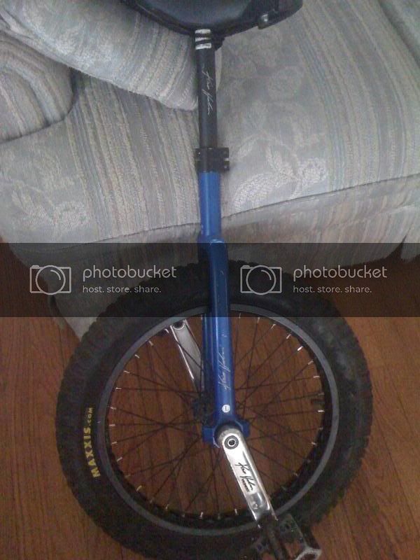

Step One: Take original unicycle, I took pictures of it to both compare and in case I needed a reference.
Step 2: Disassemble you unicycle. Be sure to keep the bolts, washers, nuts, and other small parts together so you don’t run into any issues at the end.
Step 3: Find some 220 grit sandpaper and begin the project. Start sanding everything you plan on painting. (Note: some people will tell you to remove all the paint down to the chrome, It’s kind of overkill. I’ve seen 80 grit take a frame down to chrome, and it’s very difficult to make it smooth from that point.) Once sanded with the 220 grit, go over it with a 400 grit, to smooth it out a bit.

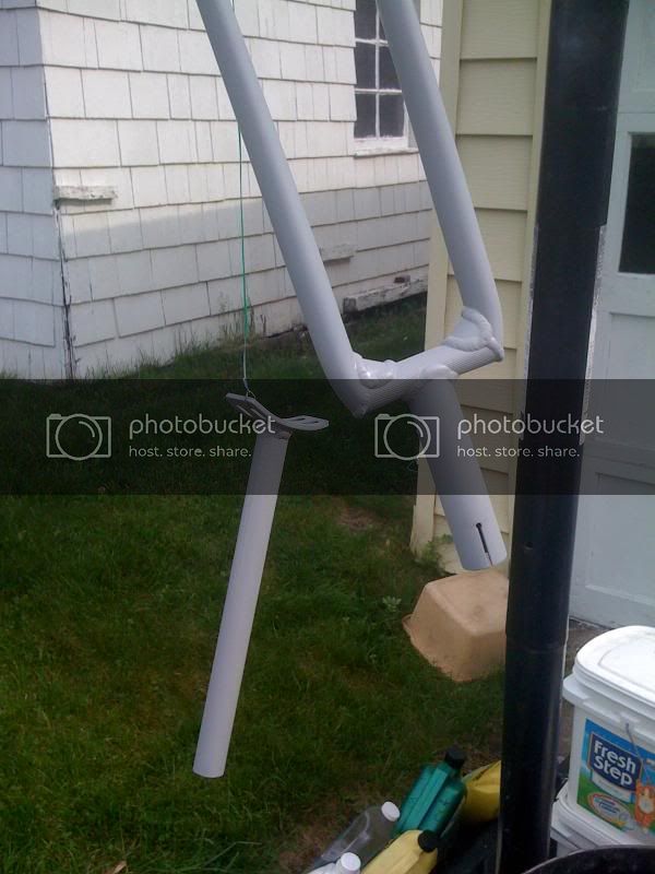

Step 4: Primer time! That’s right folks, It’s time to go buy primer. I find lacquer paint is the way to go, as you can buff it without it dulling.(unlike enamel) So, if you’re going to buy lacquer paint, you might as well stay consistent. So I bought some lacquer primer. It’s about $3.00 a can from any wal-mart. Remember to wipe down the unicycle frame before applying the primer.

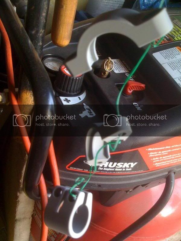

Step 4.5: I took a small bungee cord and just placed the hook in the hole on the bottom of the frame, then attached the other end to my basketball net. It’s better to use more light coats of primer, than fewer heavy coats. Read the can for instructions on how to actually primer.

Side Note: Don’t forget the little pieces of the unicycle or you’ll fall behind!

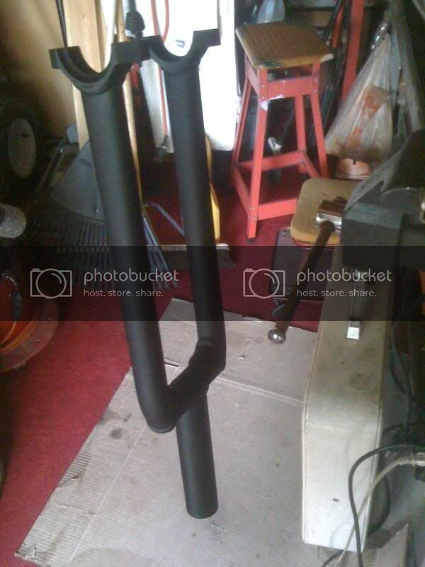

Step 7: My kit came with a special black base coat, which I applied after completing steps 1-6. Most of you will simple take the color you want to paint your unicycle and spray paint it. (again, I recommend you use a lacquer based paint) The same way you applied the primer. (Please: read the can. Spray paints are mostly similar, but can in fact vary!) Do this step until your desired look is completed.

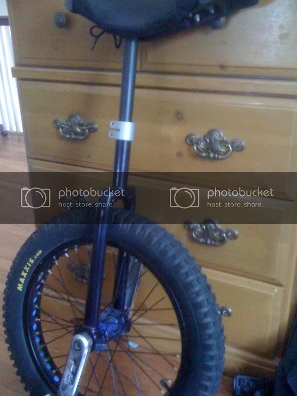

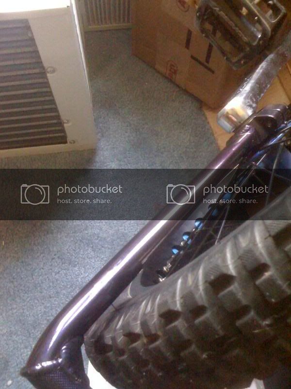

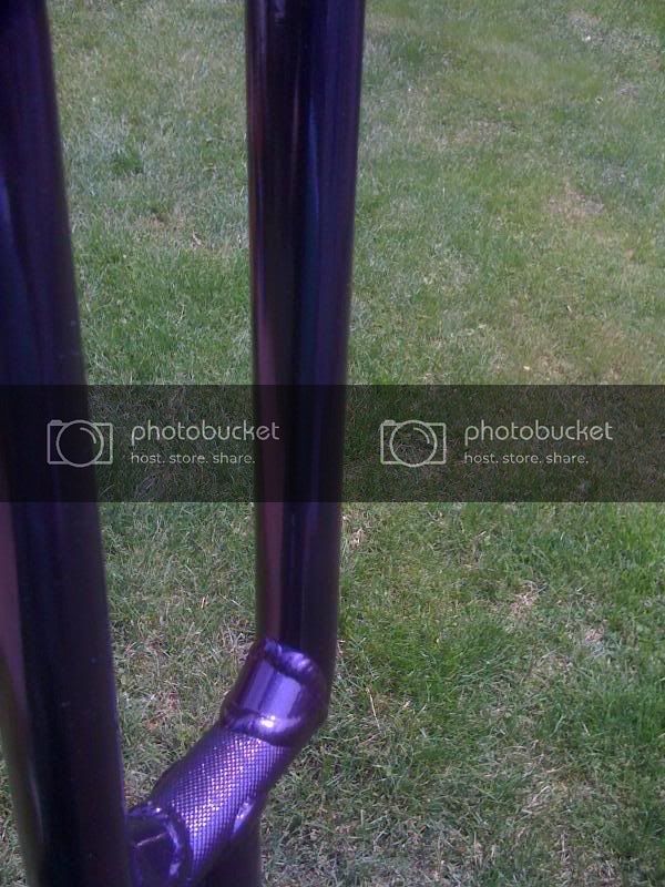

My final results:
A Kh20 unicycle, with a special paint that changes from blue to red as the sun reflects off of it different. My collar is a silver hammered paint and my seat post is flat black. I DO NOT recommend you paint your seat post. It will get scratched when you adjust it.

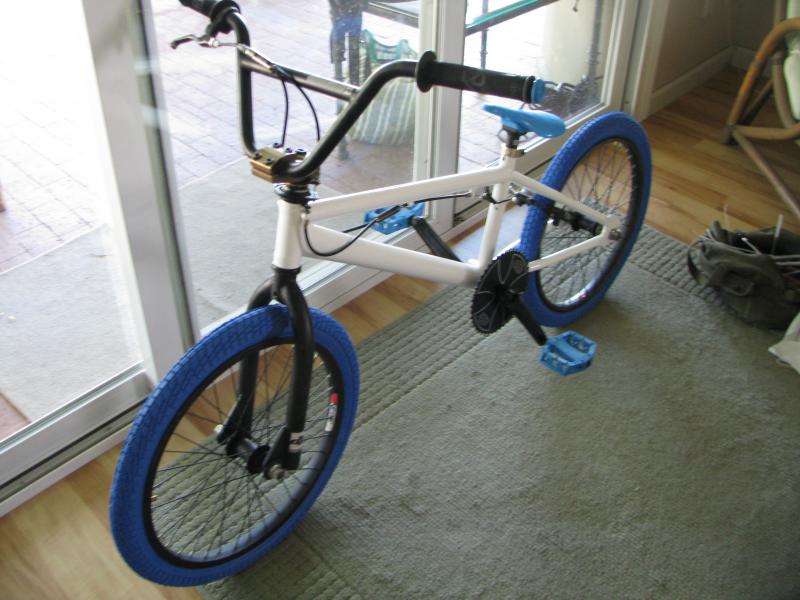

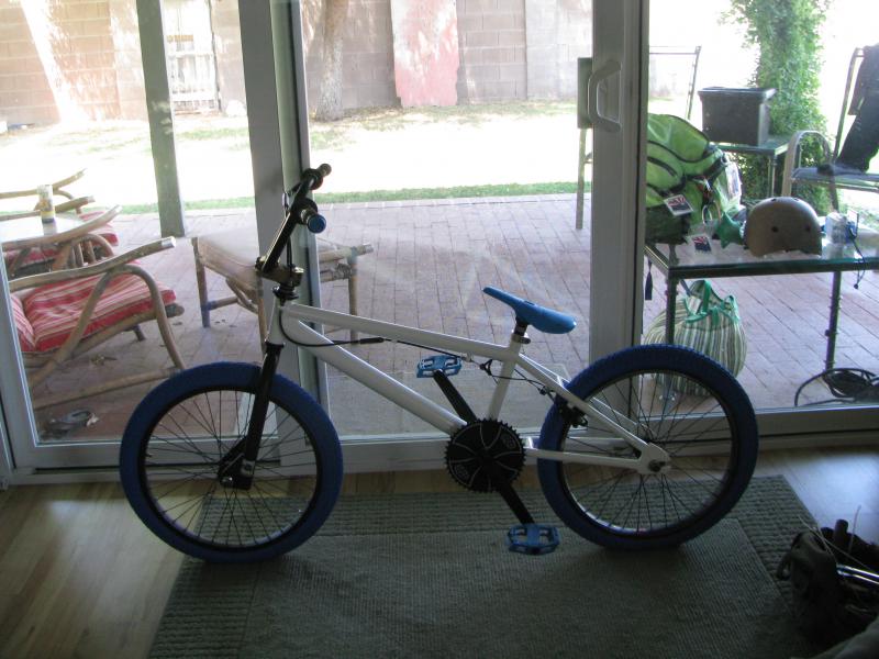

Was tan and black Now it’s gonna be white blue and black.:D:D:D Will post pics when finished.
