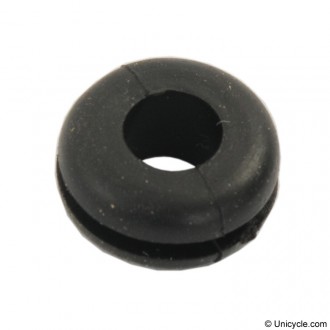

Put a valve grommet http://www.unicycle.uk.com/valve-grommet-3.html
I use it on my 36 with a 29 tube schrader valve, little bit tight but fine as 29 tube valve is smaller than 36 original tube valve
^^ get some, otherwise the edges of the hole will chafe your tube and you’ll be walking home…
