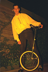

I had an eccentric unicycle wheel built for me recently. The hub was offset 65mm from the centre. It goes up and down noticably with every every revolution, but the offset could have been greater. Steve Pavarno also has an eccentric unicycle and I think the offset on his is greater than mine. The guy who built mine said he could have gone up to 80mm offset (24" wheel in a 28" frame.) I’ve also got a rocking horse saddle - I should try it out on my eccentric unicycle.

This is me with my eccentric unicycle. I have been using it as a kangaroo also.
Funky. Like the uni Leo. Well, that will give me something new to create in the shop this coming winter. ![]()
