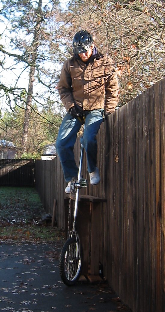

   Here's a picture of him when we first started attempting to ride.  The tail triangle piece was a simple fix....just took the frame pieces that go up to just under the seat, and bent them around (with heat of course) to meet with the straight ones.  Hope the picture helps, and let me know if you build one.

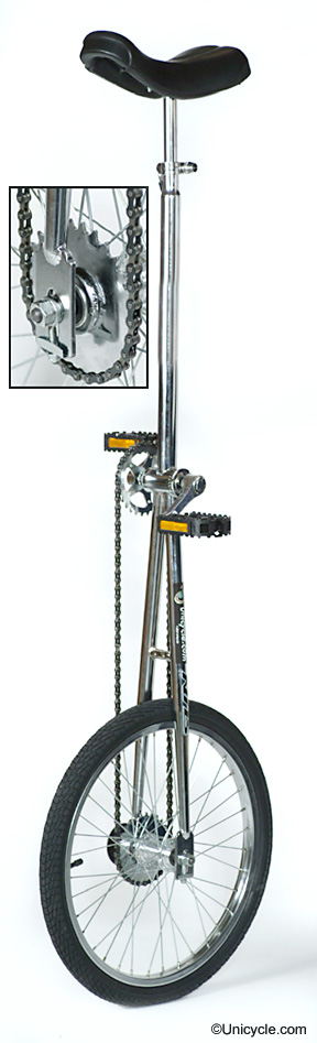

Do you think it would be ok if I didn’t use a bike fork, but instead took two metal tubes and made a T A LL frame, with a lot of clearance around the wheel , like the ones on miyata, torker, pashley giraffes? I this type of giraffe frame might be more sturdier.

Shucks, it messed my drawing up, well here’s a detailed picture of the frame.
I’m sure it would be stronger to use a frame like the one pictured, but at that point, you’re basically fabricating the whole frame. If you’ve got the resources, you might as well do it. I think the fork portion of our frame is plenty strong, but any time you have that much length of straight, thin-walled pipe (from the fork up to the seat) you’re in danger of bending from hard falls, simply from the greatly increased leverage.
