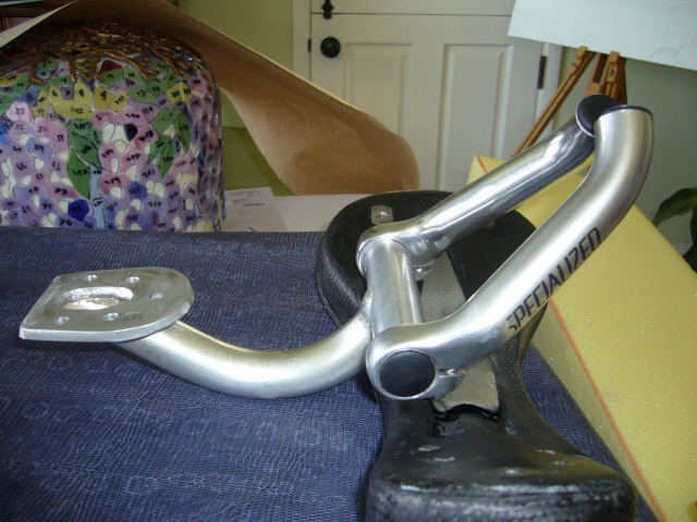

Here’s mine, a cut up road handlebar and MTB bar ends. The nice thing is that you can adjust the angle on the ends. Only cf bases are probably strong enough for this kind of mount.
That’s sweet! What handlebar did you cut up for it? Did you weld it yourself?

I’ve seen MuniVision’s handle in a prev thread and I’d love to do that if only for how it seems the easiest option. However, I haven’t a carbon fiber base nor access to it so thats not possible.
saskatchewanian: That’s a HUGE handle - doesn’t leaning your weight on it throw you off balance? Also, I’m kinda worried about stress breaks.

I would be glad to email you more photos and dimensions on my handle, with the carbon base it is actually lighter than the stock seat/handle and does not alter balance at all. If you can get a broken or bent handle bar from a bike shop, I paid only $16 for the bar ends and $20 to have it welded. Since it is aluminum, I could not do it myself. The mounting plate was some free scrap.
I really like the way it works and would not want to ride with out a handle.
I’ve seen ur handle and it’s great but the only problem is I dont think my plastic base can support it (if I’m wrong tell me and make me happy).
