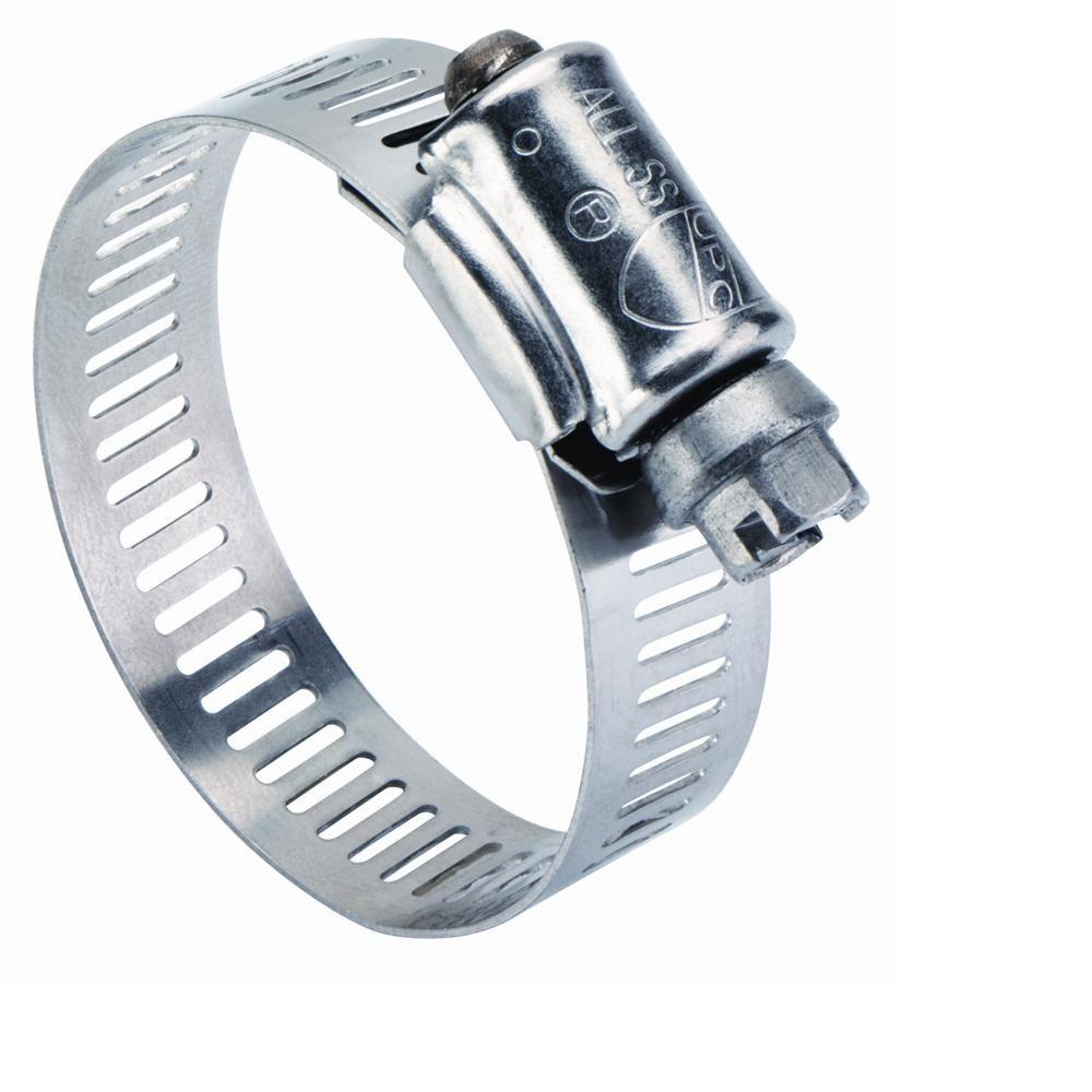

I would slot the plastic base directly over where it sits on the handle saddle tube (two slots about 1/2” apart and thread a hose clamp through and then clamp it to the handle saddle tube to back up the double-sided tape

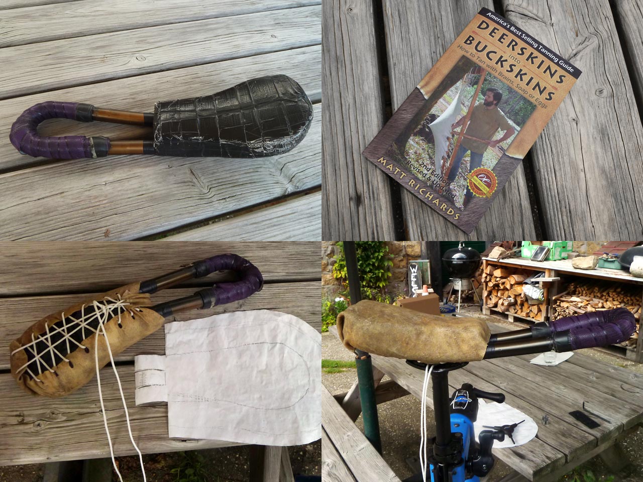

How to convert a Mad41 handlesaddle size M in ducttaped ghetto finish into a primitive skill leather saddle!
First of all you have to hunt a deer, skin it and braintan the hide into a buckskin.
Best reading instructions first.
Joking aside, I had such a piece of leather left over from a past hobby.
I made a paper template, transferred it to the leather, punched holes in it, soaked it in water and laced it onto the ghetto saddle and let it dry.
Note: the paper template is not the final version. I made a few changes in the front area with the scissors directly on the leather.

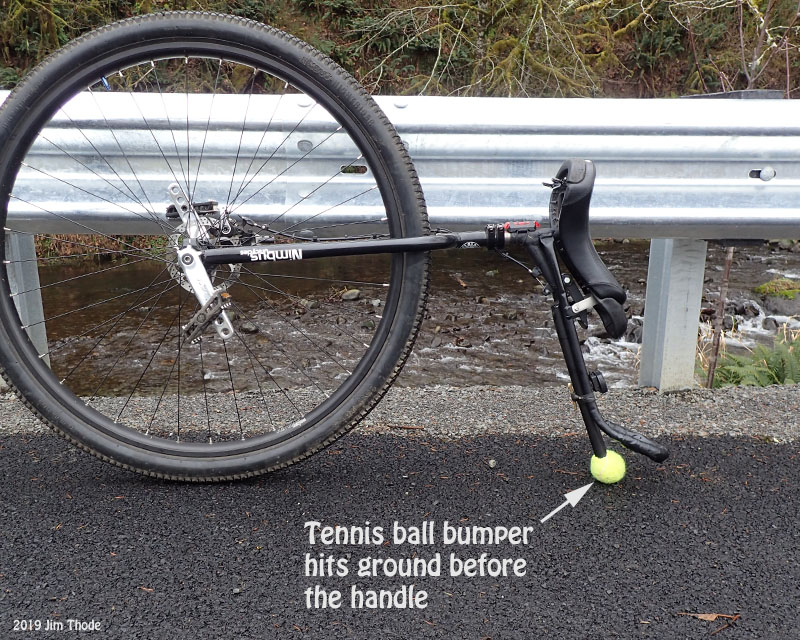

I’ve been riding handle saddles for the past 6 months or so and what I’ve seen is that the leather bumpers and handle wraps are great for muni, but for street/flatland/trials they slowly get chewed up. When leather hits dirt very little damage happens, but when leather hits concrete or asphalt damage gets done.
I saw someone on here mount a tennis ball as a front bumper. I love that.
Yes, one thing missing from the handle saddle and add-on commercially available handle’s is a tough and durable bumper.

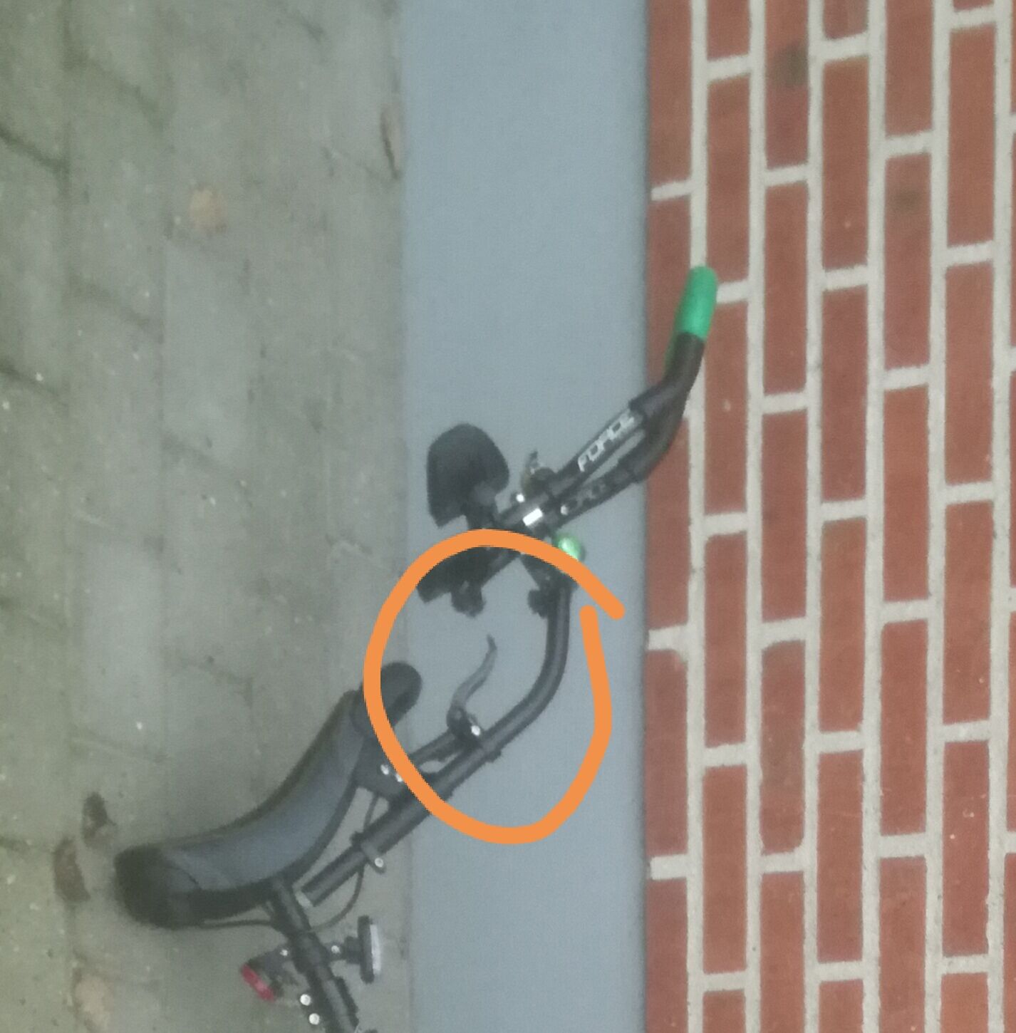

Also the reason that im very careful about were I place the break.
I started placing it up-side down.
Yeah I was always careful that my brake lever wouldn’t hit the ground first, rather be a couple of mm off.
One day after a deep clean I messed up reassembly, got it too far forwards (and noticed immediately but decided to leave it until I got home again) then shattered the carbon composite lever on a UPD…
It was an expensive UPD.

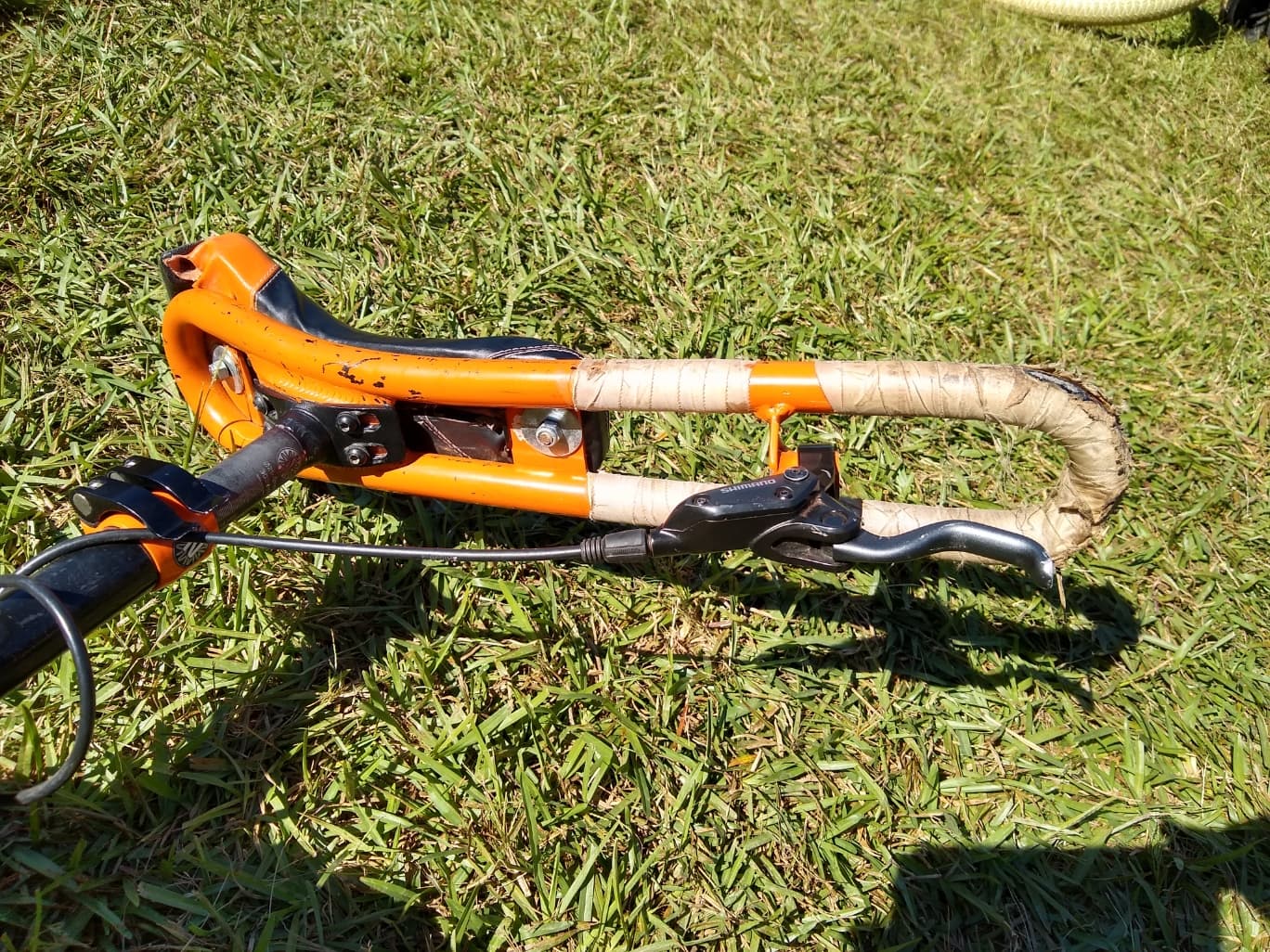

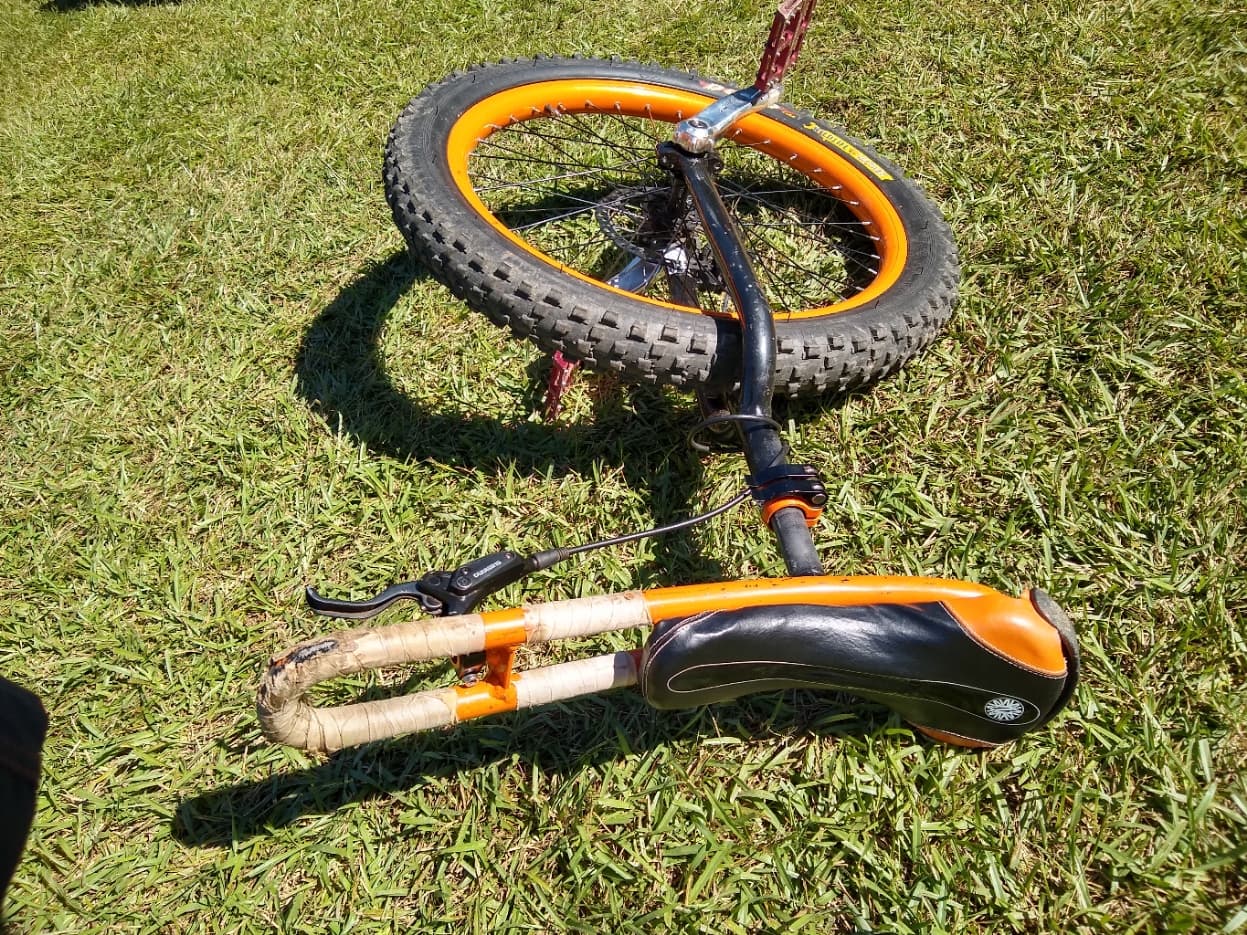

So there’s an improved version now; here are a couple of photos. The saddle mounts to cross pieces welded to the handle; there is another crosspiece, with a stub of tubing to mount the brake. The brake mount is placed farther forward than before, so that there is space to grab the handle close to the saddle part, for pulling up while climbing etc.
