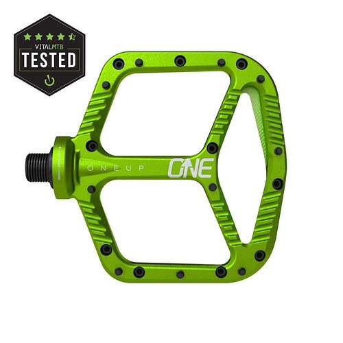

Quick review from me for these OneUp Aluminium pedals.
I’m using these on my G24 and they have really surprised me. The grip feels like a lock :locked: and yet I’m still able to angle my heel to shift gear or change my foot placement a smidge.
The confidence they give is great and compared to the Hope F20s I use on the G29er they are really night and day. The Hopes aren’t bad, but they have a more slippery feel to them overall. They have a wider platform than the Hopes too but not overly large. I’m sold on these now and would get another pair over the Hope line up any day!
I guess downsides are the pins on these pedals look lethal whereas the Hopes seems a bit safer for your shins.
I did worry the large axle bearing would somehow get in the way but it doesn’t and I really love the fact this is designed to be super serviceable.
