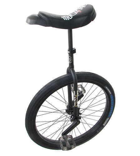

If you don’t plan for brakes and don’t need teh oppotunity to add them later, this one might fit your needs: QU-AX Muni 584 mm (27.5") schwarz - QU-AX, 379,00 €
That said: I thought I would not need brakes when buying my first Muni but I was totally wrong and had to tinker a solution a year later or so.

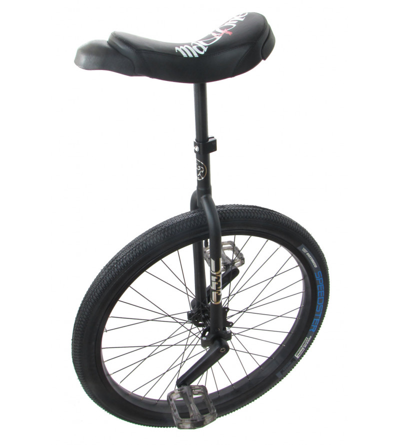

This is a pretty good road unicycle, for a somewhat low price. I got this last year with the handlesaddle. If you want to go unipacking, you would probably be able to add on some accessories.
I wouldn’t recommend buying from unicycle.com, most things there are quite expensive, they’ve been slowly raising the prices of everything in the last year. (They are pretty good quality too, but there are other quality unicycles for less)
I just want to mention that you can not add easily add disc break easily to this one. So this an option if you do not need a disc break.

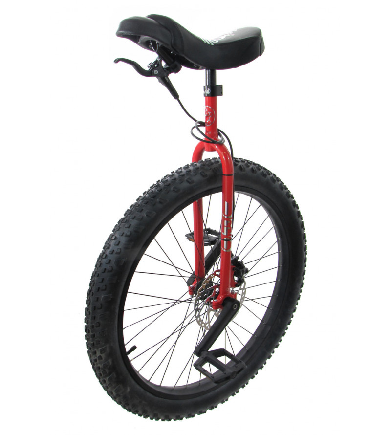

Then, I’d definitely opt for a 27.5" Muni. If you don’t need the brake yet, take one, where it can easily be added afterward. Take a wide tire if you intend to go on rougher terrain and a thinner one, for easier terrain. The wider tire makes rougher terrain easier to ride as it offers more suspension / dampening.
Those are both good candidates:
Both feature the pretty wide 3.25" tire and the option to buy it with or without brake.
This one can even be configured, though some options (as the skinnier tire) aren’t available at the moment:
This one is also configurable in color:
Unfortunately, at the moment, no seller offers such a uni with a 2.8" wide tire, which is, what I would have recommended to you.

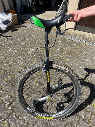

This one is used, offers a rim brake and a faster tire and is only about 30km from you.
Could be the perfect ride for you.
