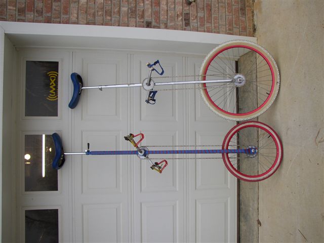

As per Harper’s request in the 2nd reply, here is a picture of my Giraffes. The Schwinn Giraffe was retro-fitted with a 26" wheel (& a snazzy white mountain bike tire circa 1989 or so). The other giraffe was built by Tom Miller of Unicycle Factory fame. I did the red & blue striped paint job.

Hey, those are cool looking. Nice photos, Mike. The paint job is really spiffy.
Do you really use the toe clips? How is the ride of the 5 foot, 26" compared to the 6 foot, 20"? It looks like they’re both geared about one to one so you should be able to distinguish some differences in ride, speed, and control even though there is some height difference.

The paint job was achieved by spray painting the frame blue, then after it dried I used electrical tape to cover the frame with 1" gaps. A coat of red was next, and its lasted for 13 years.
The 26" rides much faster, and I’ve said the 20" is for show (juggling, jumping rope) & the 26" is for “go”. It is pretty fast, and is more twitchy that the 20" when trying to maneuver.

I wish I hadn’t seen that, now I have to add another wheel to my collection :sunglasses: Nice uni’s, steep driveway though.
Did the 26" wheel fit the Schwinn’s frame without modification? I knew there was room in there for a 24" wheel, but didn’t know about a 26". The same should be considered for the 26" wheel on the Savage. Make sure you have enough clearance!
The 26" wheel fit the old Schwinn frame with no modification & about 3/4" to spare.
