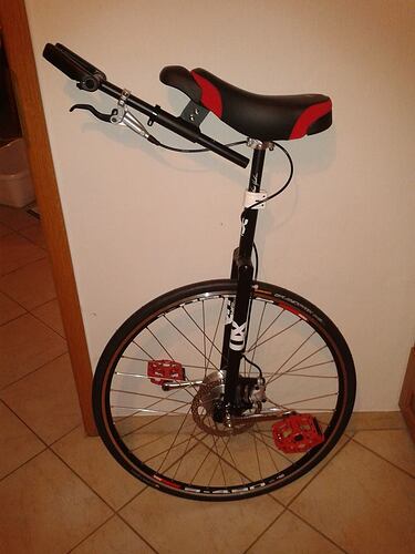

Christoph Hartmann raced at 2016 Unicon with a fixed geared uni from his own design : 2.6 ratio with a 28" wheel
This is not the right solution from my opinion

Any hint on what would be the right solution? Just being curious, there :smirking_face:
Even so, Christoph Hartmann thought he was faster with this uni than with his G36… I think it was a 26", I’m not sure.

It was 28", I had separate discussions with Christopher some years ago
