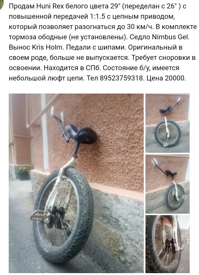

It looks like, Huni Rex is the chipest geared unicycle. About 200$.
But not so many riders want it.
It seems to me that the pedals are very far apart each other, a huge Q-factor, if you want. That‘s something that puts me off a bit. And while the frame looks quite pleasing, it also looks pretty massive (read: heavy). On the other hand, the solution with chains is a lot lighter than a geared hub…
