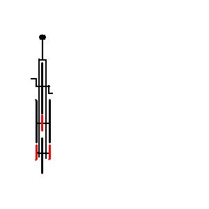

If unique is more important than light, practical, and easy to pedal, you could do something like this.
> |Filename: unique.JPG |
> |Download: http://www.unicyclist.com/attachment/10841 |
Now THAT looks fast, if it can be made to work.
