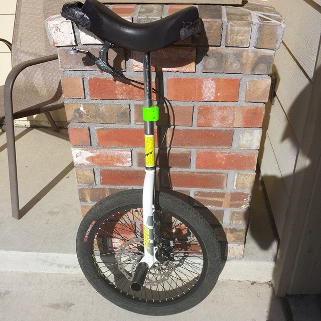

Nico is the god of the BC wheel and I don’t think he ever tried a brake. Terry (Unigeezer) considered it but I don’t think actually built it. I made my various peg unicycles and took them off road and to skate parks. In my opinion a peg unicycle is better than a BC wheel with a brake.

What is a peg unicycle?

This is Carl Hunt’s peg unicycle
