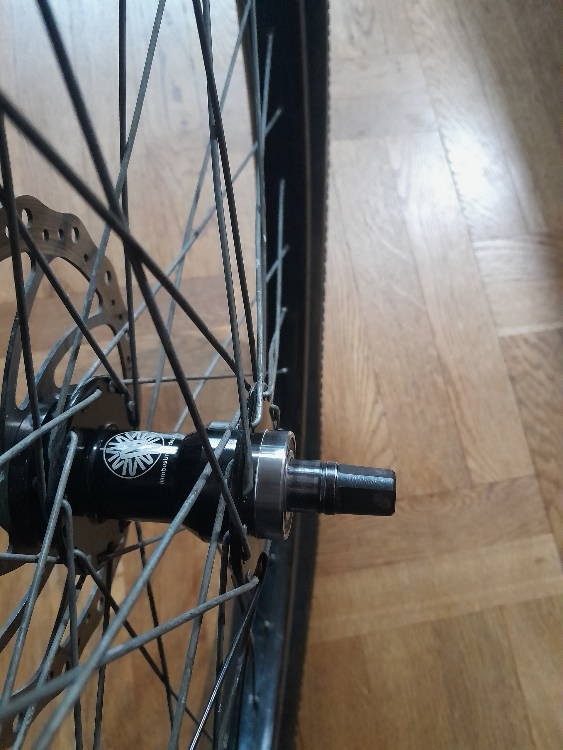

Thanks a lot. I bought the parts and I thought about to change the Rim, because it is a Steel rim and not in the best conditions.
I searched for a spring for a long time, bought standard springs, but none of them were suitable for the nimbus drift trike hub. One year ago, I ended up buying two kits from UDC, but I think they were the last ones left.
How do i get the axle and the bearings back into their correct position?
i thought the bearing was loose on those hubs?

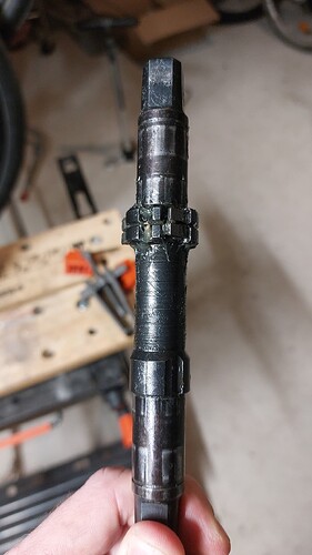

Ouch….thats not very freewheeling now. How did you manage to do that ?
@Maxence you had a similar problem with your hub; or was it different ?
The exact same issue on both of my hubs :slight_smile:
Regular muni riding, ocasional drops little jumps (like here: https://www.youtube.com/watch?v=cbQ356eqL4w). I have it since july 2024, used from time to time since i ride fixed mostly and last year i had 5mo brake due to twisted ankle. I’ll contact local qx dealer if he can help to fix it.
In general i’m bit dissapointed since i belive i didn’t land anythig crazy.
It looks like PPF can’t handle jumping at all. Sad part is there is no relaiable freewheel hub on the market.
Do you think the cause of the breakage is related to landing jumps rather than too much torque during the climb?

Since i barely climb using freewheel i’m conviced that jumping is a weak point of this hub.

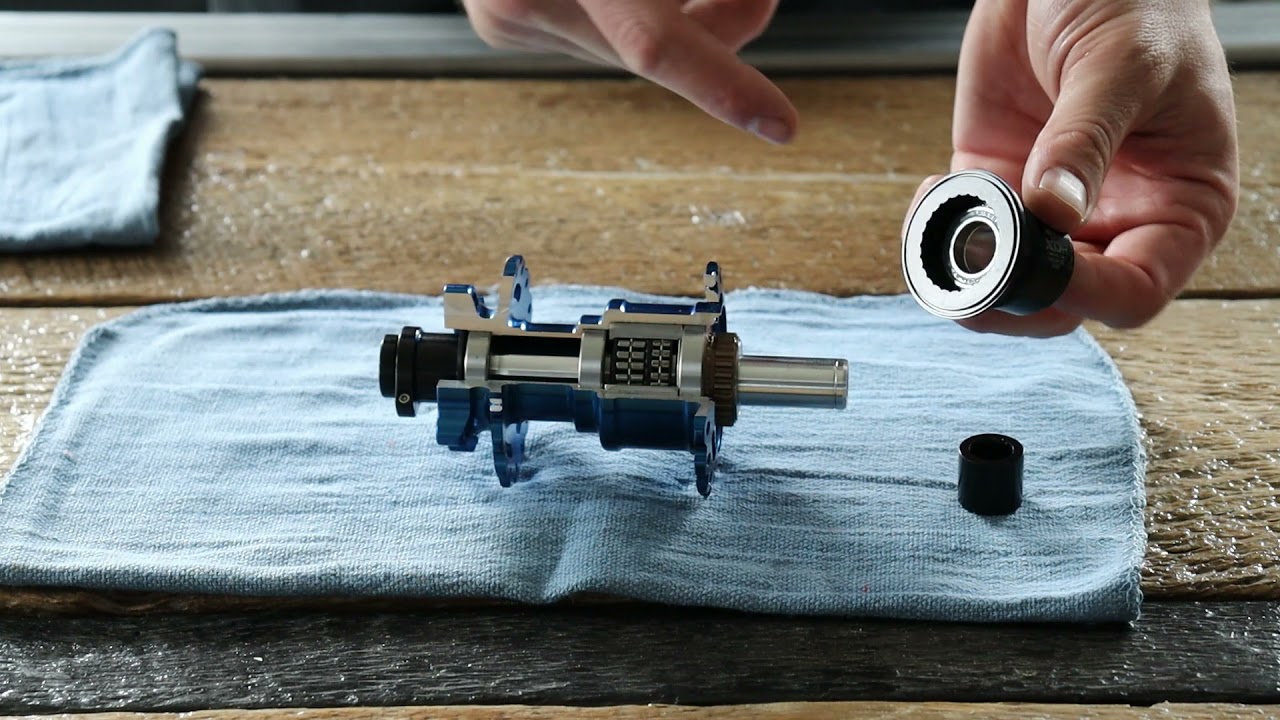

I’ve read the information Stieber provide for this bearing and assuming that’s what’s failing I’m not at all surprised. It’s very much not its intended purpose.
Onyx Racing use sprag clutches that are not also bearings, and they’re pretty sizeable things. They also sell spares as people still break/wear those: Sprag Clutch - Onyx Hubs Europe
Onyx have some great videos showing how their hubs go together. Some of them have two sprag clutches, but all of them seem to have three bearings to ensure correct clutch spacing if the axle or hub shell flex.
