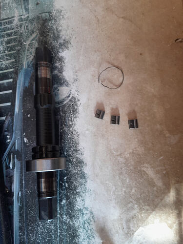

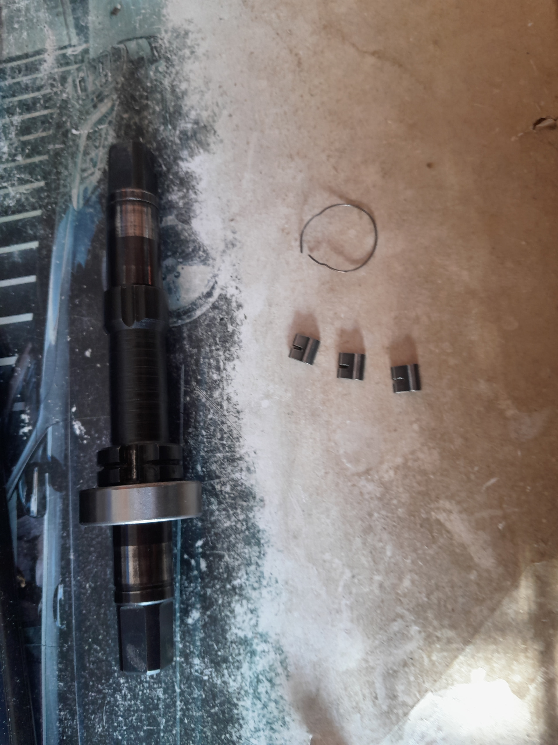

Can a wire be used to secure the looking blades? It is the Nimbus Trift Trike Hub.
you probably need the spring
Where can I order the spring?
no idea but im sure its a fairly standard dimension so i guess wherever you get your springs. someone else here might know the dimensions
Those should have a standard singular size so if you can find a BMX hub with a small size sprocket you can take that apart for extra pawls and a spring
