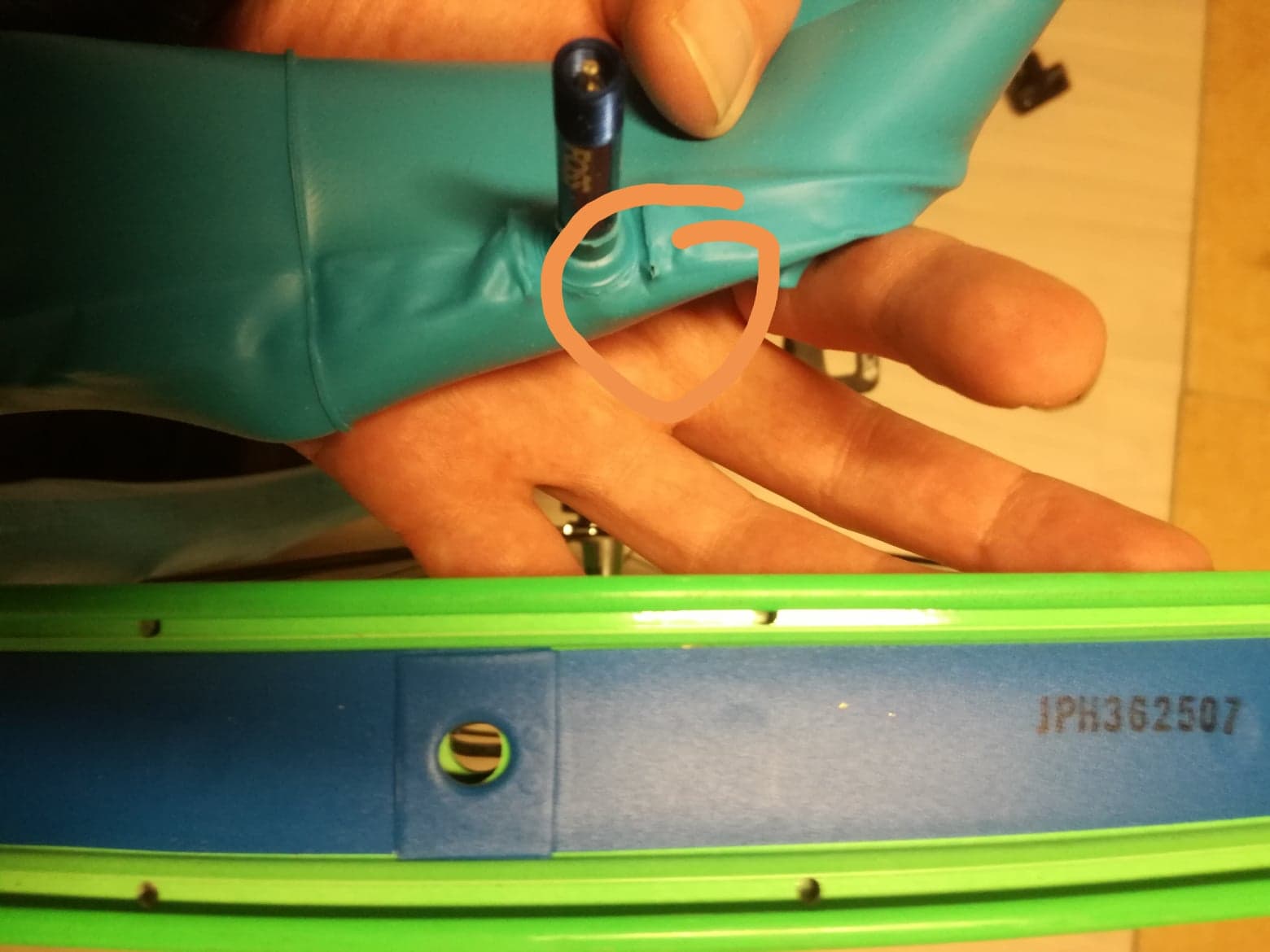

A few nights ago I was woken by a sudden “wham” sound and hissing noise. The 36" foss tube had suddenly blown.
At first I thought it was the valve, because the that’s where the air was coming out from. But taking it apart I found this:
The extra layer of the rimtape ends have created a tension point. I really like the foss tubes; they may be puncture resistant, but they are not durable, it seems.

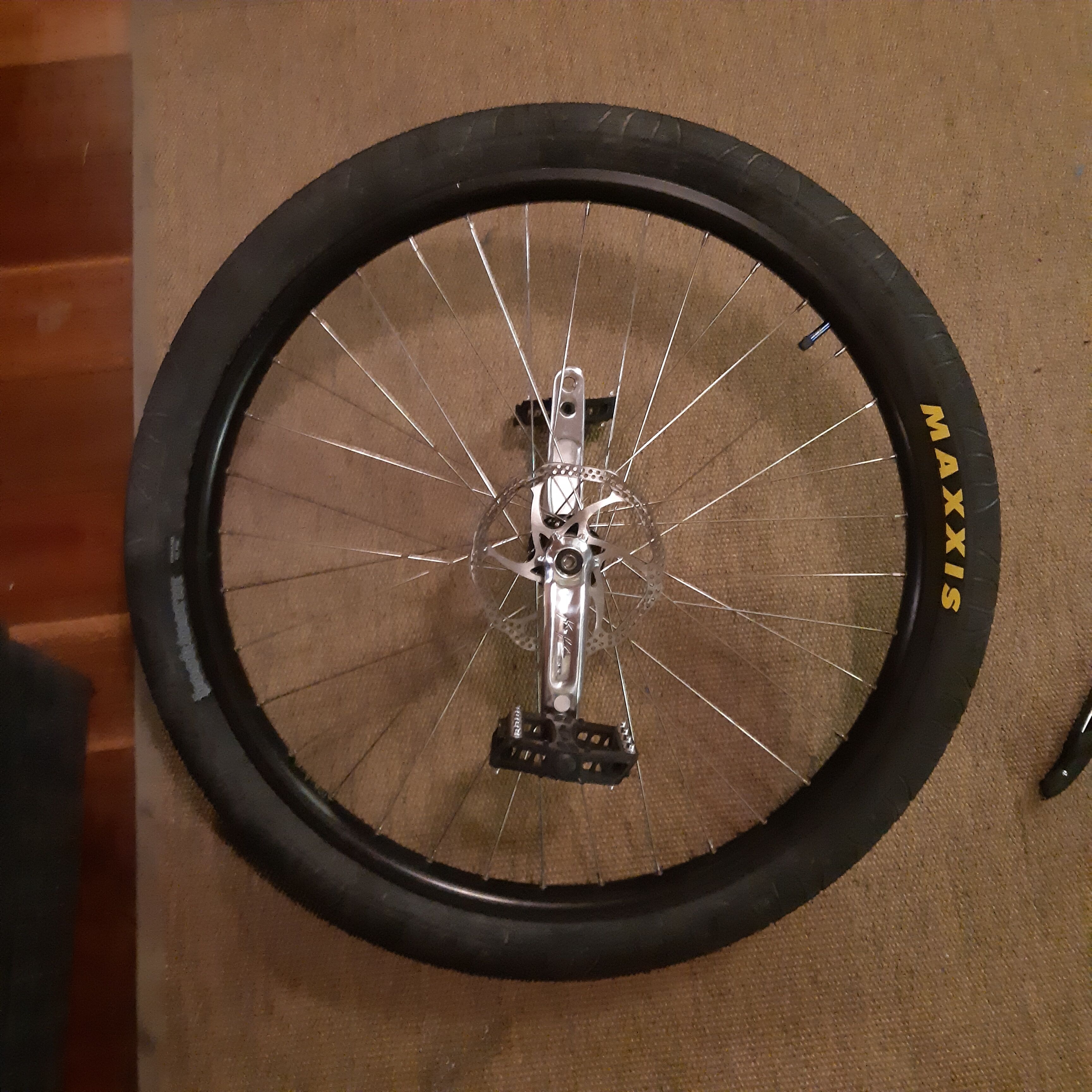

I have a Foss tube on a 29er. It’s been completely issue free, till I replaced the tyre. I replaced the tyre, inflated, then had a small slow leak. So I repaired the leak. All ok. (I left it overnight to be sure). I put the tyre on again, reassembled the uni and then discovered I have a leak again. So annoying. I havent further repaired it as I find putting this tyre on and off a big effort
I have now patched it a second time… so far, so good. I think it was my method for putting the tyre back on. My tyre levers were pinching the Foss tube…

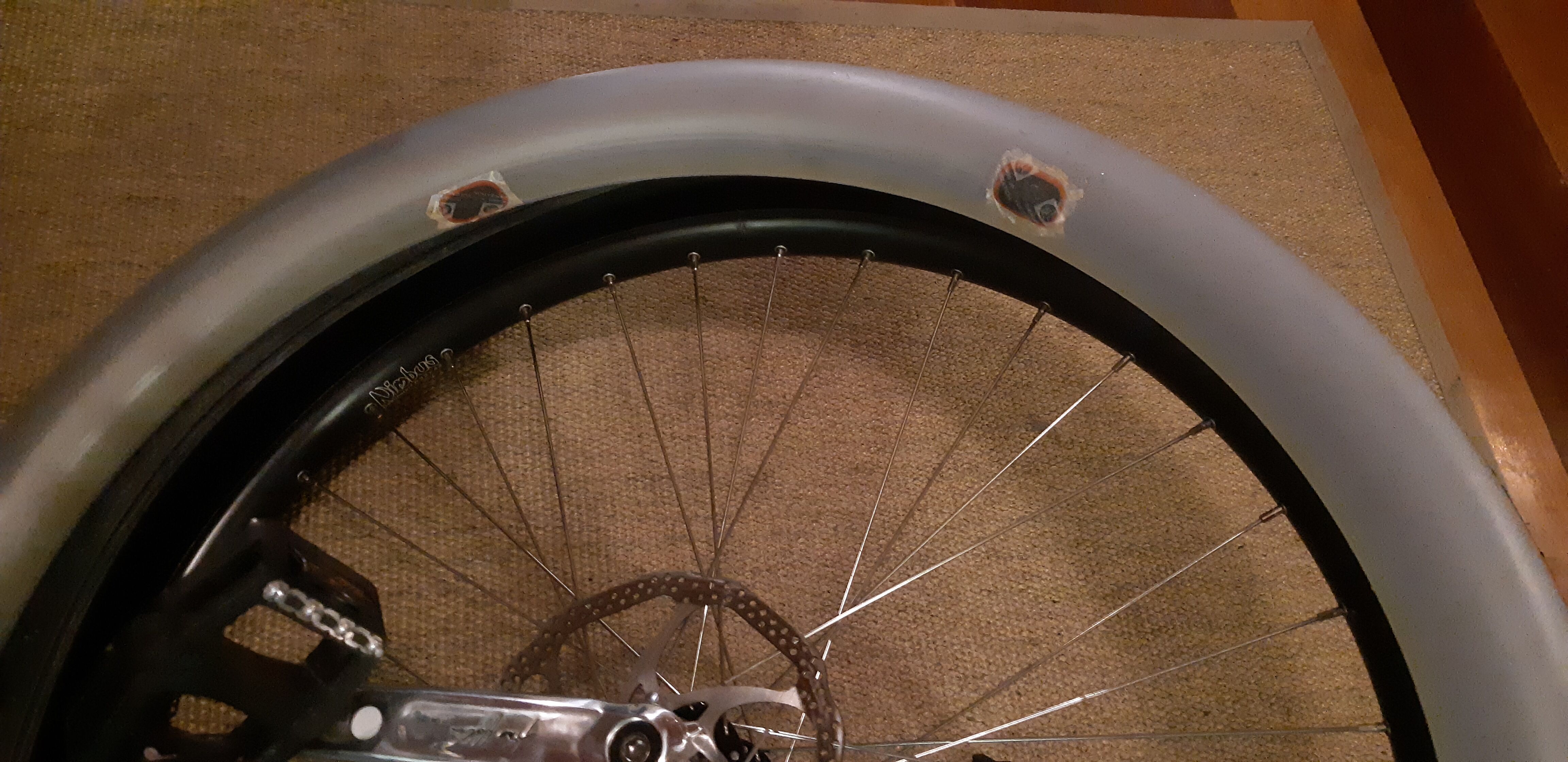

Pics of mine.
You can’t use normal bike patches to fix foss tube (I read), and I doubt I can get the patch on the corner of the valve. But I’m gonna try.
Yeah ok, not an easy spot. But worth a try.
I have already done it, the thing is I won’t be installing it anytime soon. Unless my rubber tube, I just installed, fail.

However, I’d guess that your tube was a little weak right at that seam at the valve and the pumping wiggled it a bit and it broke through there. I’m rarely successful patching near the valve stem. I use a new tube if I get a leak there. Other places can be patched, but the valve stem area is really troublesome.

Not sure whether or not it’s the rim tape doing it but I had two Foss tubes fail in that same spot on my 36er. After the second one failed I gave up and put a 29er tube in instead.
Good to know I’m not the only one. My fix is holding; I guess I will bring it as a lightweight spare.
They often fail at the valve, where you can’t do anything to fix them. Often it’s because when you inflate them, and wiggle the valve, it puts stress on it. And as they leak more than regular tubes, you do inflate them more often.
