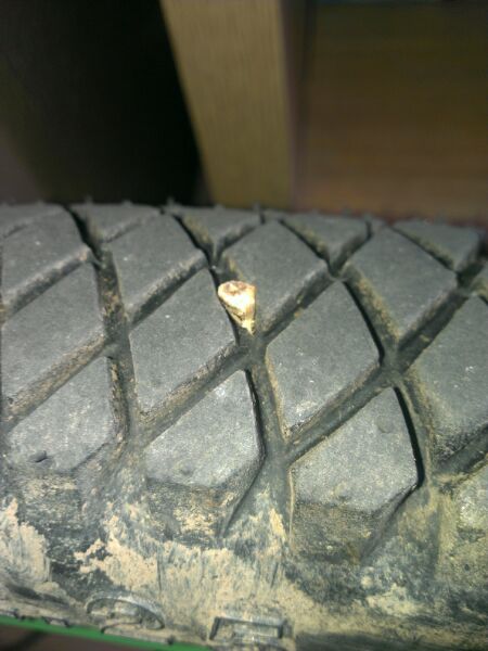

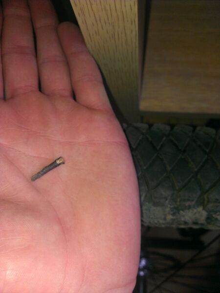

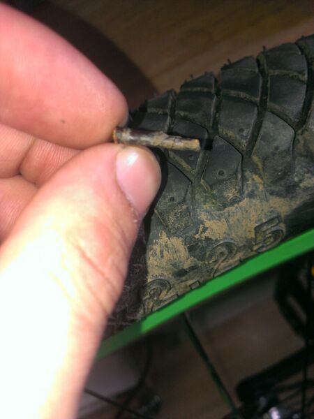

Just to update this Foss tube thread. I’ve had my 36er Oracle, with Foss tube as standard, for about 1000 miles. So far no problems, although I did notice I’ve needed to top the air up a little bit once a week, for the last couple of months. Then today I noticed why…
Yes, the pics show what has been stuck in there for the last few months! :astonished:
So I guess I can safely say that it self seals when punctured.
It deflated in about 5 seconds, when I pulled that tree branch out :stuck_out_tongue:
I’ve got a Foss patch kit on order, and will update when its (hopefully) fixed.
