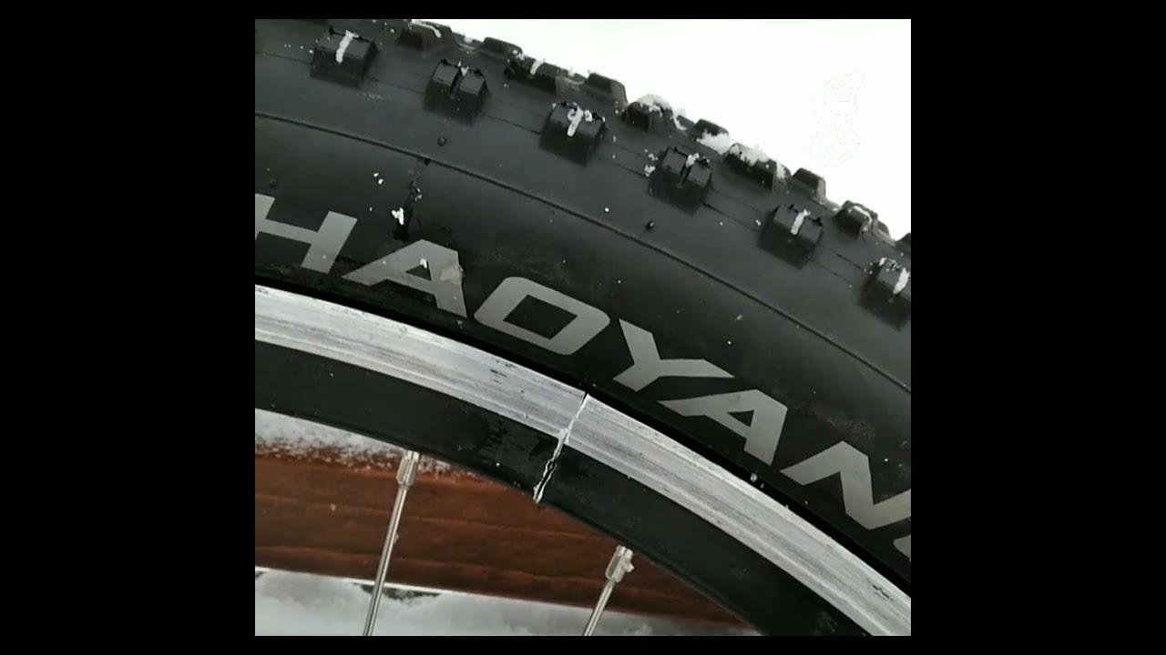

Hi,
the next my folding 29" rim, narrow one, 27mm.
So, I save 400g. in weight in comparison of 46mm rim and get possibility to use and 29x3 trial tire, and road slick 700x35 on the same rim. It tested already, with success. Attentive viewer can see my invention, “know how”, curwed cut line. It lets to ensure correct position of rim sectors ends.

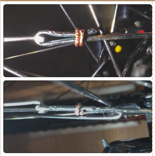

Hi,
I did mean about two parts spokes, not about rope soft one.
This is my current constructin.
It is easy available for hand make, and works well.
Although I begin to think, that not so often we need to dissasembly and assammble the wheel, to think about to save several minutes or not.
Meanwhile I have techology now, know how.
Riding test on video. Folding rim and one folding spoke are there installed:

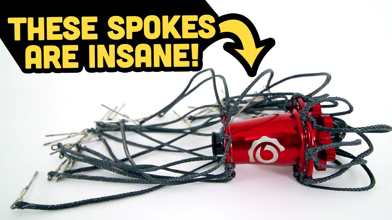

Here is Ali Clarkson’s latest video – on homemade “rope spokes” with Tarty Bikes. I haven’t watched it all yet since it is quite long but it should be pretty interesting.

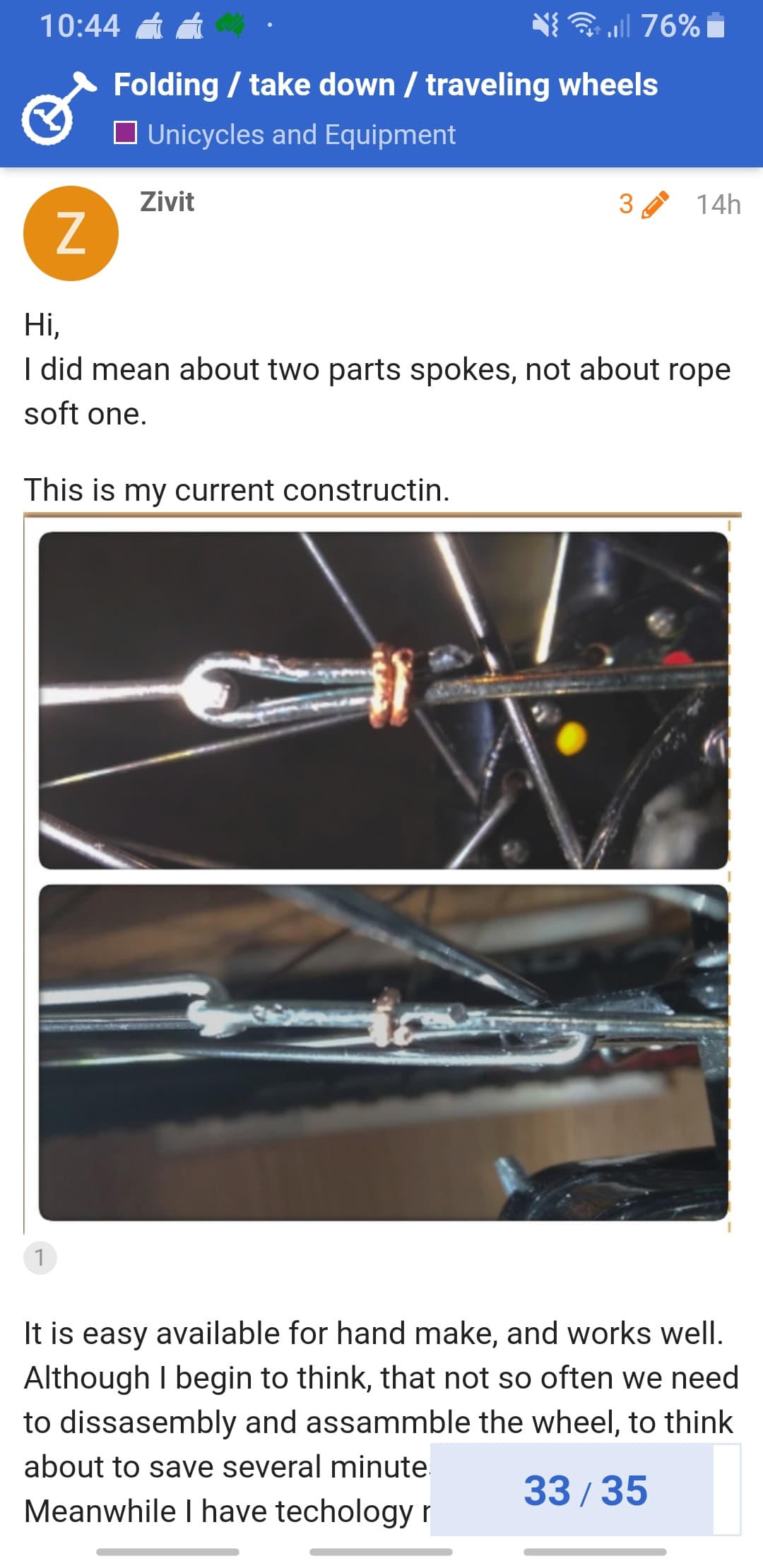

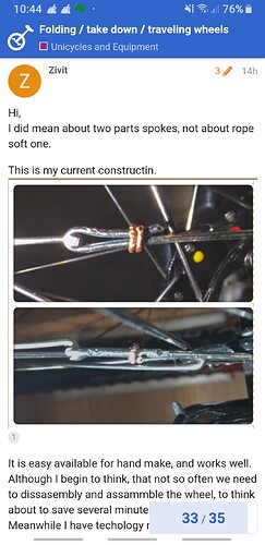

You’d probably be best off using the forum’s inbuilt upload function for images - for whatever reason I can’t see that image either on here or by visiting where it links to.
Is this the image you can’t see?
Images show up fine for me. Also, the rope spokes seem cool and perfect for this, however near the end of the video it is mentioned that you need to true the wheel multiple times after riding for a bit until it really starts to hold as the rope stretches. This would probably be an absolute pain to do even somewhat frequently. But to take an idea from that video, perhaps the copper wrap could be soldered to the inner spoke for a little piece of mind and to keep things from working loose.
I especially made so thin and small copper wrap for testing. Only one turn of very soft wire. I wanted to check, is it enough for fixing the loop. Yes it is enough. So I know, that there is not so much force doing. Meanwhile, the loop wlthout any wrap opens a little after tension.
