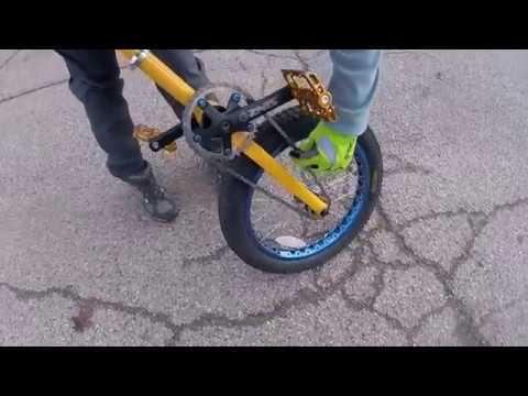

This came up in the recent thread about giraffes recently (linked below). I also posted a video of my penguin (a geared 19" trials wheel, 2:1 ratio with 150mm cranks, similar to a 36er with 125 cranks) as well. There is no off-the-shelf solution. If you want the speed of a 36 in a more compact package, a schlumpf hub is the way to go if you can afford it. It’s very close to a 1:1.5 ratio, so a 24" wheel is geared like a 36. They are more difficult to ride than a typical ungeared big wheel, but not unreasonably so. If you want a cheap, portable, durable solution, a 29" wheel with short cranks is a great option. My penguin is slower than my 36er, but it will cruise above 10 mph.
