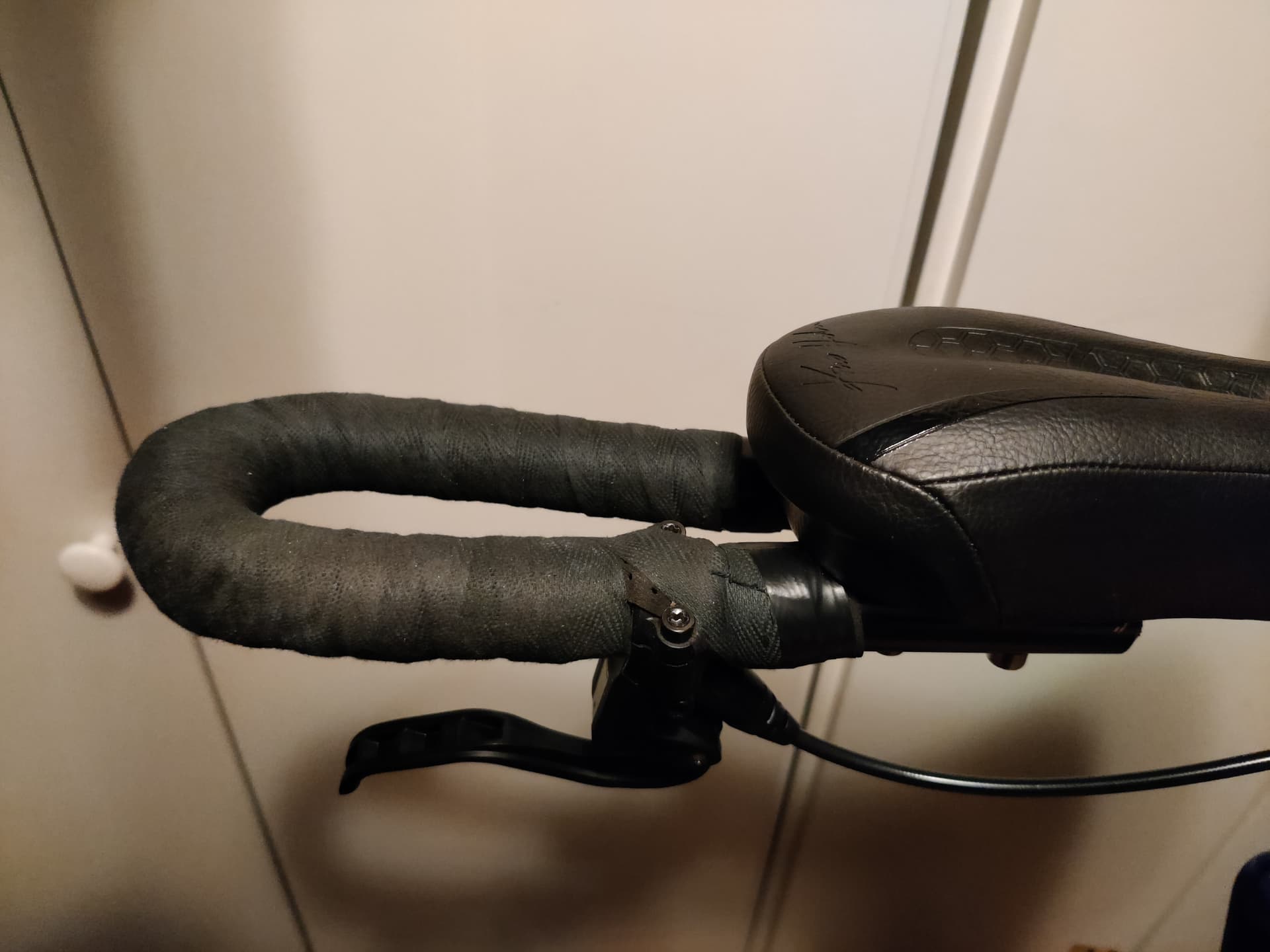

Its a lot wider between the legs than other saddles and secondly if I stand up to hop, when I go to sit back down the saddle often has moved backwards so I am sitting really close to the handle and I have to specifically pull the handle forward so that I am sitting on the back part of the saddle again. I don’t know if this problem is just due to how I set it up, I would like to know if other people have this problem or not.

I suppose if I get rid of the seat falling back issue, I like the M41 Saddle handle, I’d use it for muni, I have the short version, I like the handle being close in and super strong, with the brake placed in between the loop, in the ideal area reachable from the handle for me. I feel that’s the ideal setup for my muni riding in terms of brake and handle.

Have you tried altering the angle of the saddle. Seems like something that a more nose up angle could maybe resolve.

Try adding a few small washers between the front of the seat post and the saddle. It makes a world of difference and even allows you to ride hands free. I’ve been riding with mine shimmed up for several months now and have seen no signs of damage or premature wear because of it.

The handle saddle is excellent in many ways. From a male perspective, it doesn’t squash your anatomy if you sit on it wrong. Doing muni I find that it is quite comfortable. On the street however I find it uncomfortable after about 3km. The difference being that when I ride muni I’m constantly getting up out of the saddle and when I’m riding on the road my weight is supported by it for long periods of time.
IMO the handle itself is a huge improvement over the grab handle on the front of most saddles. You can get a really solid grip on it with either hand or hold it with both hands like a small handlebar. For out of the saddle climbing I find that grabbing it at the very front works best as it seems to keep me better balanced.
A loop style handlebar also has less of a tendency to injure you when you fall on it or it falls on you.
So far I’ve tried three varieties of handle saddle, medium, large and trials. For most muni I would want either a medium or small so that I’d be able to stand and climb while grabbing the front of the saddle. I’ve got the large on my 36er and the front of that is simply too far forward to make that practical. The large does allow you to use the loop better with both hands however and for road riding it would be the one I’d want.
The trials version is excellent if you’re not actually riding it any distance. You can get a rock solid grip on just about any part of it, but the padding is almost nonexistent and you’re pretty much sitting on the handle itself.
