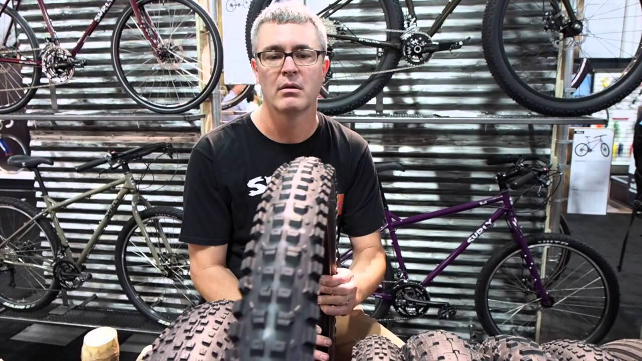

For your viewing pleasure :smiley: 5"!!! :astonished:

Unfortunately, the Knard presented is a 26x5.0. OTOH, they presented also a Dirt Wizard 29x3.0, so interesting video and good news for the 29er addicts (nooooooooooo another nice tireeeee !!! too-many-already, too-many-already, too-many-already…)

And the guy from Surly was exactly how I imagined you’d have to be to work at Surly - Barking mad :smiley:
That Surly interview is just too silly :slight_smile:

I completely agree. That guy is awesome.
Does anyone know if this is 29x5" or a 26x5"? Bc if it’s a fat 29", I think it’ll look a lot like a fat 36". :slight_smile:
Annnnd I would want one.
Sadly, he mentions putting it on an Ice Cream Truck, which means it’s a 26er. Oh well. Dare to dream right?
