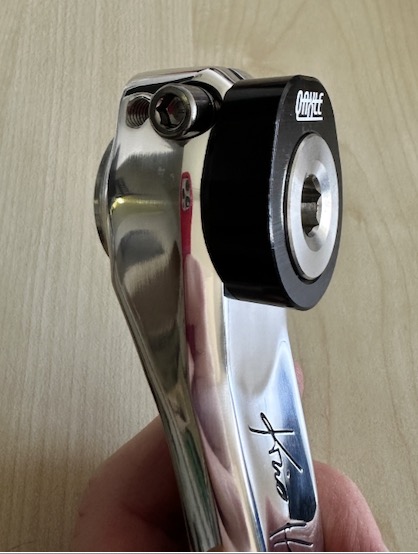

Here’s a photo of the Boundary Cranks with Rollmops installed.
What do the Rollmops do or permit?
They provide a wide, predictable surface to stand on. Rollmops crank extensions enables smoother and more stable crankrolls / Rolling Wraps.
They enable you to keep a cleaning supplies closet more compact (as mops are taking less space when they’re rolled…).
{This message is probably approved by @harper :squinting_face_with_tongue:)
As qu-ax is a german company, rollmops in german are savoury rolled herring bites
Rollmops are a typical German fish speciality - the name alone would probably be difficult to translate. The sour and savoury rollmops have made a career for themselves as a hangover breakfast. But the rolled herring bites are also delicious as a snack, on a buffet or for dinner.

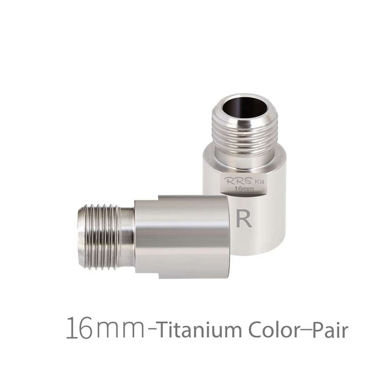

Would this be an alternative? It extends the pedal axle by 16mm - 20mm depending on the model
Practically: yes. Aesthetically: no. :wink:
future Schlumpf adaptor + KH Bundary cranks is the solution
I’m not quite sure it it actually is functionally the same, with pedal extenders you can still accidentally place the front of your foot very close to the axle, while with a high q-factor crank with heel clearance you can’t.
