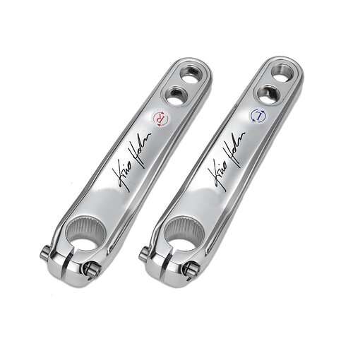

I’m excited to (finally!) announce the release of an updated KH lineup for Fall 2023! New to the range are the Boundary cranks and hub, which will replace the Spirit cranks and hub. Boundary cranks build on the proven Spirit cranks geometry with several improvements.

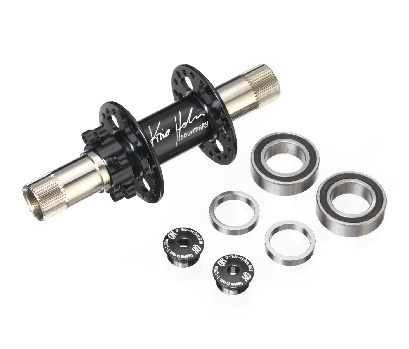

The major update is to the spline interface, now with Q-Axle micro spline. Qu-Ax’s innovation on the hub has proven itself - lightweight (380g) and strong with extended use, and KHU has adopted the same hub design. For those unfamiliar, the spine is parallel (not tapered) and secures with pinch-bolts on the crank – it’s easy to install and remove without the wear and tear of a tapered spline. The Boundary hub is 100 mm bearing-bearing width and is 36-hole.
The Boundary cranks are forged from 7050 alloy with 8 mm outwards flare. That is 4 mm less than Spirit cranks. I’ve ridden with these cranks for a year and really like this profile – slim with clearance to avoid bashed ankle bones or heel clips. Boundary cranks are available in these lengths: 110/127 mm (373 g), 117/137 mm (414 g), and 127/150 mm (444 g). The 165 mm version is discontinued. While this may make a few riders unhappy, there’s too little demand for it anymore, and eliminating it shaved a few grams off the weight by designing the forge tooling for a 150 mm length.
The KH20, KH24, KH27.5, KH29 and KH36 are all KH blue and have the Boundary Cranks and hub – meaning an internal disc brake (excepting the KH20). While I have been happy with the external disc brake, this brings the KH range into compatibility with the hub-mount standard. Too many “standards” is a real issue in the cycling world, and I think our sport is better with compatibility across brands.

These look great, but I do wish there were a 32H version of the hub. My last two wheels were 36H Q-Axle hubs built with 32H carbon rims - because I could only find 32H bike rims, and because Qu-Ax only offers a light duty aluminum hub in 32H.
Building a mismatched wheel isn’t a huge problem if you do it yourself, but I don’t think many shops would do it.
My experience is that 32H is plenty for what I would call “aggressive cross country” riding (including over a decade on a 29" 32H KH rim!). It would be really nice to have it as an option for people looking to put together a high quality custom wheel.
I’d second the 32 hole option. I feel 36 hole on complete unis is fine, but most people that build their own wheels want 32 hole if they can get it. I have a had lots of people reach out saying they can’t find a reliable source for 36 hole rims.
I have 32 hole wheel built, and found 2 more hubs I’ll be shipping from overseas just to have them on hand for future wheels since they are unobtanium at the moment.
KHU does not produce a 32 hole hub, but - note that Qu-ax does produce a 32 hole disc version of the Q-Axle hub that would be compatible with the Boundary cranks and the rest of the KH setup.
