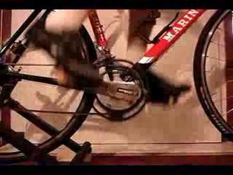

More recent examples of similar designs:
Rotor cranks - use a cam mechanism to provide cranks with uneven rotation speed.
Revelox cranks - use cranks which change length depending on location.
I don’t think they are actually in production (surpirse!) but they seem like they might not be a terrible idea on a unicycle, though I can’t say I see them improving speed or efficiency either. :o Especially since crank lengths are short enough that spinning isn’t really that hard.
