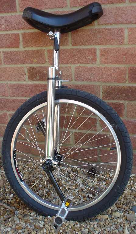

I have just finished building my first eccentric wheel.
Perhaps the pic will come out this time… sorry, it worked in the test forum.

What is the offset and crank length?

It’s a 20" wheel with a 50mm offset. The cranks on it are 145mm.
I can ride it with the cranks fitted as pictured (9 O’clock and 3 O’clock with offset peak at 12 O’clock)
It is not too difficult to do short distances but I find it very tiring and run out of steam after only 50m or so.
I am off out to try with the cranks both pointing at the longest spoke now, if you never hear from me again it could be a bad sign…
Lovely, I’ve been thinking about making a wheel like that for a while, just curious, did you calculate the spokelength? if so, how?
Or did you make the spokes as you built the wheel?
I used the spoke calculator from here:
It worked fine although some of the spokes that enter the rim at an oblique angle could maybe do with an extra mm length to compensate for the kink in the spoke & the nipple not pulling down flat because of the angle.
I managed to free mount it & ride 14 pedal strokes so I am happy. :slight_smile:
It is not too difficult and it is a great feeling to be bobbing up and down like a well known marsupial.

Wow! Great work Mike. Did you have any problems lacing it?

Andrew: I laced it in the same way as normal but some of the spokes need to be bent into quite a tight curve to get them in. I took care not to kink them & they straightened out ok. If anyone has a better way of lacing an eccentric wheel I would love to hear please. The other tricky bit is guessing how much tension to put on each spoke, in my case I just did what felt about right from experience of building normal wheels..
