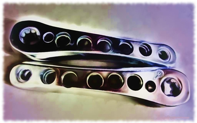

Cranks can be a work of art! These are my just-drilled moment 110/125’s. And what a MESS it makes with alum. shavings everywhere! :astonished:
(Effect by cartoonize.net)
how much do they weigh?
The original weight per pair is 458g. I haven’t weighed them yet, but they’re noticeably lighter…and also look cool! I’m in talks with M41 to make some custom lightweight, three-hole cranks for me. :slight_smile:
I just weighted them! The pair is 106g ligther than it used to be (498g VS 604g)! I dont know how strong they are now, but it doesn’t really matter since I used them mostly for XC on my Geared muni.

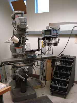

Bump. Does anyone know where one can have their Moments drilled? I have no access to my own drill or any machinery for that matter. I would pay someone to do it, but I have no clue where to even go. Home depot? A bike shop?
Any suggestions?
crank drilling
try and find a small engineering company near your you ,preferably a company with a vertical milling machine shown in picture , they might need to make a jig to hold the cranks while they machine them
another option is a company with a wire eroder or wire edm then you could have any shape you want in them oval etc also very accurate into microns
Im an engineer and at work we happily do small jobs for people who knock the door and ask for a quote
good idea is to do a drawing of exactly what you want and how accurate you want them to be
id be happy to help you if you cant find anyone near your you would just have to post to england uk
you want a machine shop; bronson silva, of silva cycles, has a setup to do it. I think I forwarded his info to you before.
-corbin
Oh great! Thanks! I’ll contact him next time I’m in California!
Thanks for the info and the offer to help! The shipping would be a bit too high for me though. :slight_smile:
No problem brb
