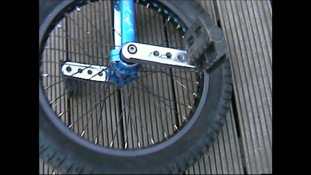

here a minivid with the 125mm i think it is 10mm
3holes = 125mm
4holes = 137mm

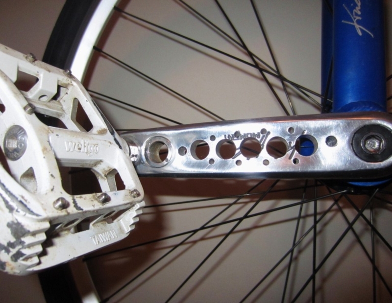

My “crop circle” cranks. :smiley:
(they are noticeably lighter!)
I never posted mines, I drilled 4 3/4" holes. They are 137mm cranks. I haven’t weighted them yet. I’ll do that as soon as my Schlumpf goes on vacation for the season :stuck_out_tongue:

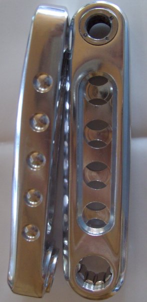

I used the big one (3/4") all the way through. I drilled another pair that I use for Street, there’s 3 holes in each cranks and they are a little bit smaller. I have pictures on facebook, I can’t post them right now since I’m using my iPod.
I did have a pilot hole… But the press-drill wasn’t really good and it didn’t drill directly on the pilot hole.
I have also drilled my 137 moments with 4 3/4" holes. Works great. I used a smaller bit as a pilot and then stepped up to the 3/4" bit. I used a drill press and lots of cutting oil.
I wanted 3/4" holes but the largest (traditional) bit I had was 1/2". I was able to get 5 holes plus several smaller ones, without coming so close to the edge of the crank arms. So I probably got roughly the same weight savings with 5 holes at 1/2" than 4 at 3/4". :slight_smile:

Those are my drilled KHs.
Saved 62g/crank - thanks to Norbert Liebl who drilled them for me!

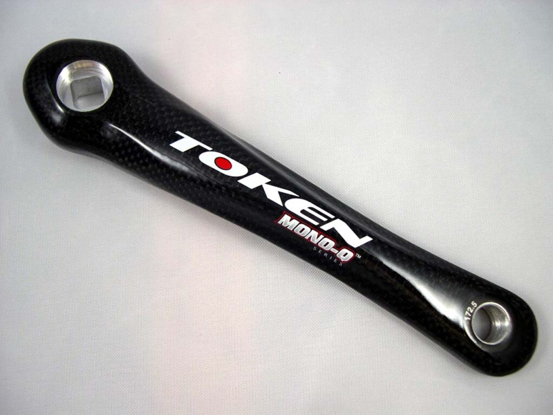

Yeah I just bought the 3/4 step up bit and finished enlarging the 1/2" holes I had initially drilled. Cut through like butta with a little motor oil. But for ultra light cranks, which I would use only for road climbing, CF uni cranks would be the ultimate! Just use inserts in the pedal & crank hole.
Carbon cranks won’t save you any weight unless you’re trying to reduce the size of your bank account/wallet:
http://americancycle.com/product/fsa-carbon-pro-bmx-crankarm-175mm-2941.htm

I’m pretty sure the spyder adds a fair amount of weight. And I would get 165’s not 175’s, so both those things would likely put the cf cranks in the 300-325g range, per pair. Plus, they’re just cool looking, and it’s only money…which isn’t worth much nowadays anyway! :smiley:
