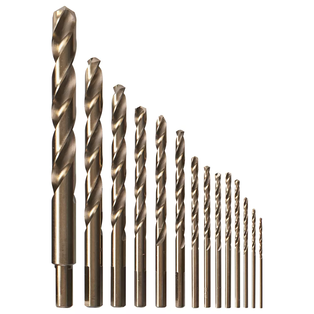

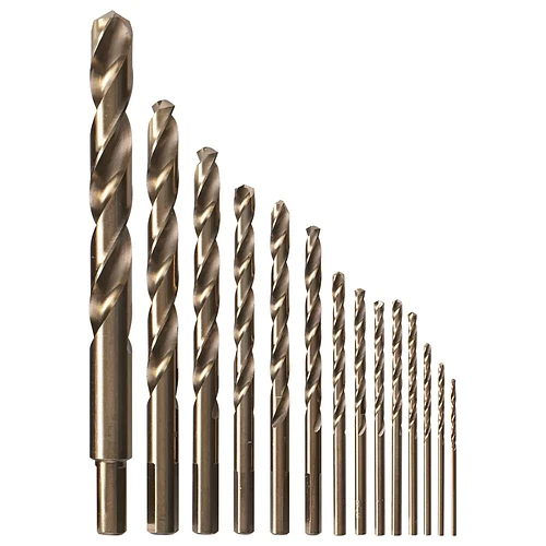

You want to drill progressively bigger holes ending with 1/2"
using bits that look like this:

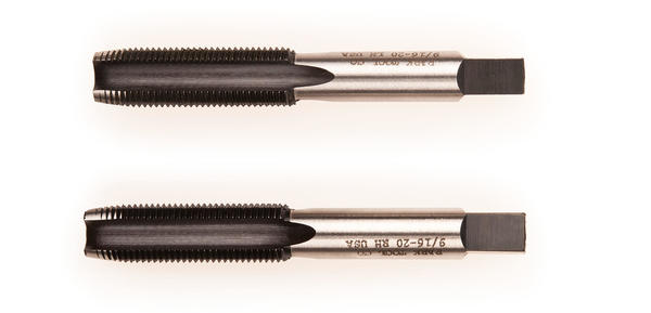

Then thread them with taps that look like this:
They need to be 9/16, 20 tpi in both right and left hand thread. I’m sure there are other ones out there but the only readily available ones for the consumer market are made by Park Tool.
