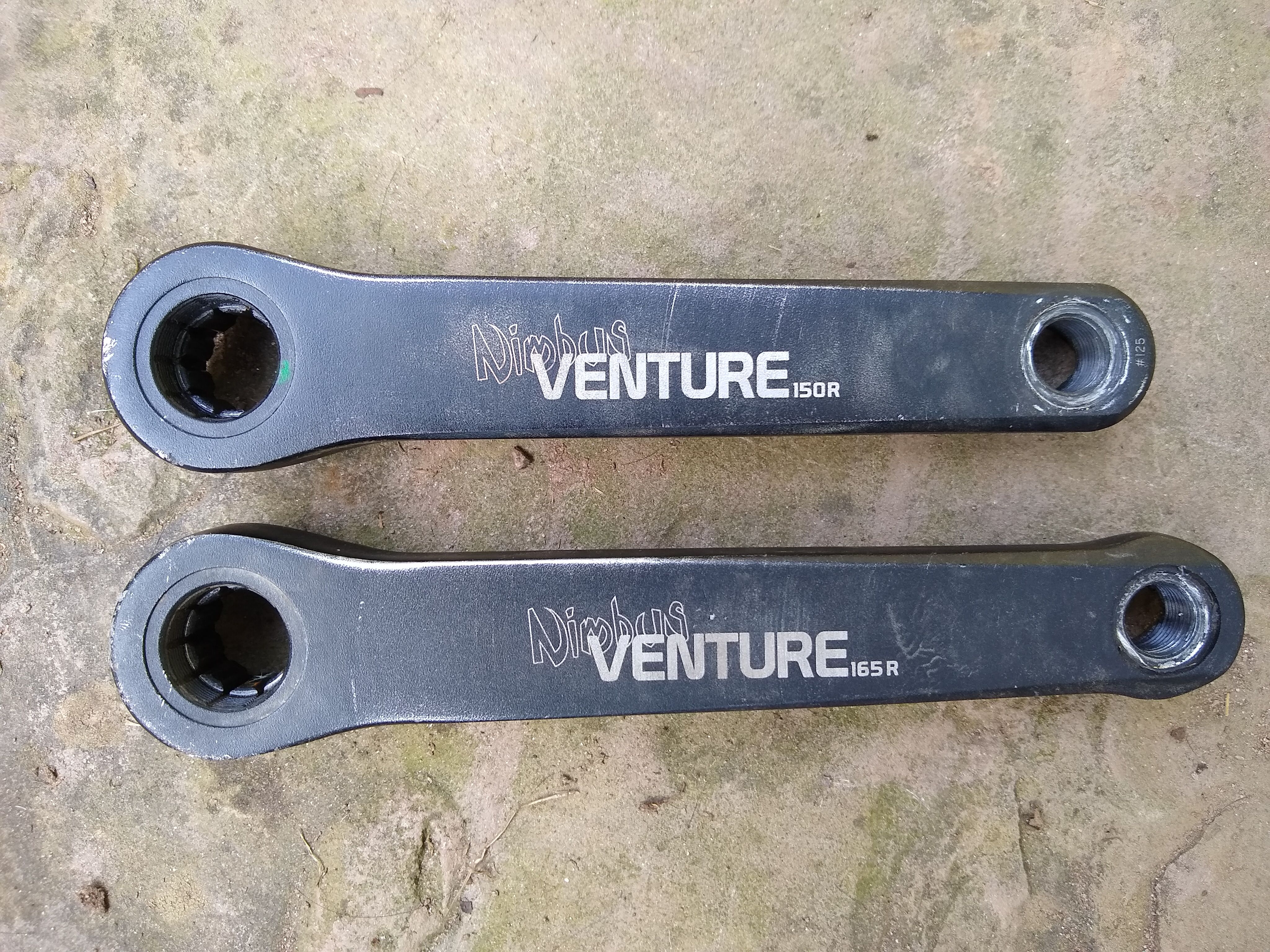

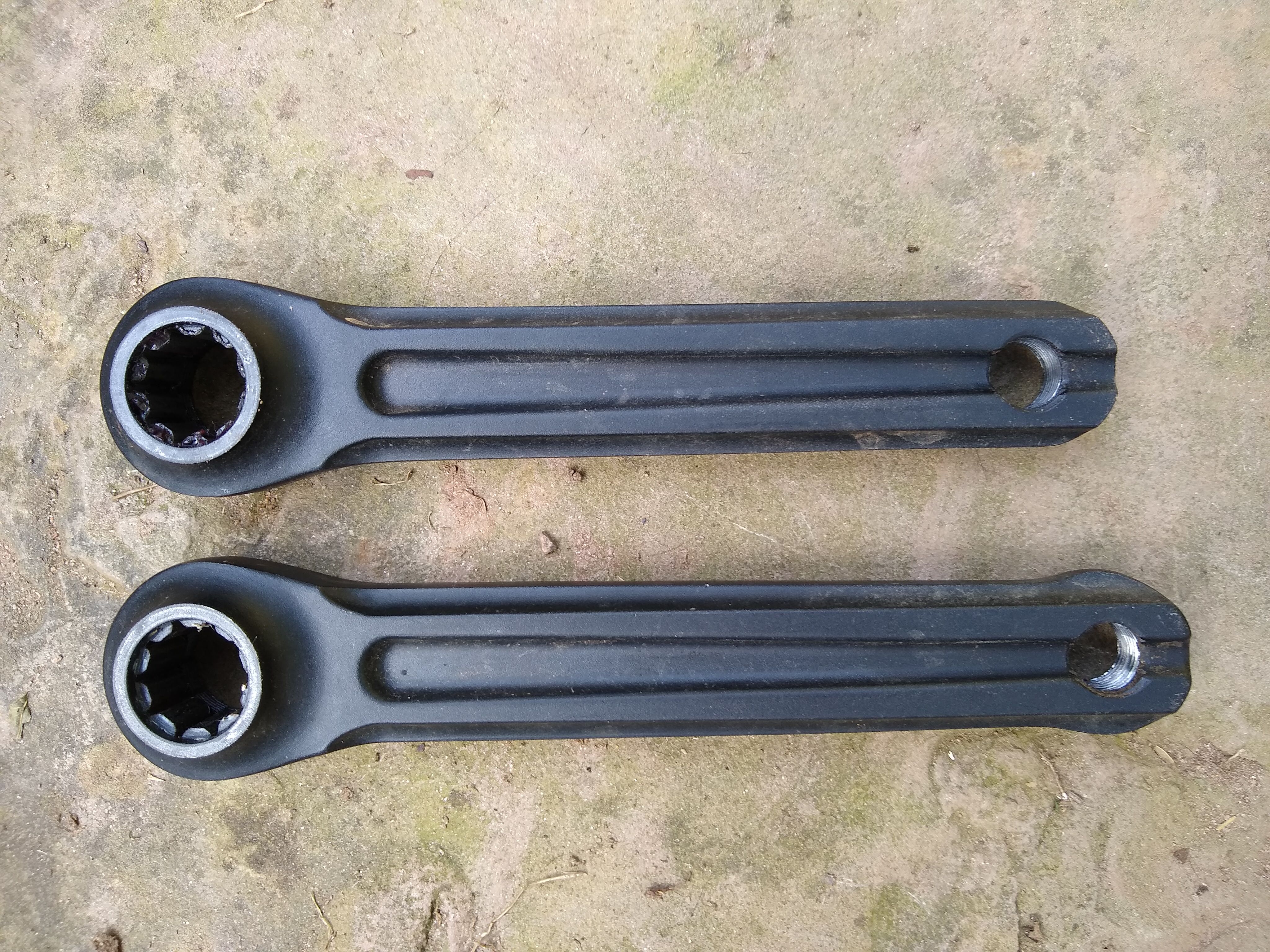

Apropos of “highly engineered”, I’ve also noticed that almost all of my shorter cranks are just longer cranks, cut off. I imagine it’s too expensive to have different forgings for all the lengths we unicyclists demand. The only exception in my collection is my 127mm Sun Isis cranks (which are, ironically, probably my cheapest cranks).
So the shorter cranks are over-engineered, since the longer ones have to be stronger to support the forces from the rider’s weight, at the end of a longer lever.
These Venture 2 cranks show what I mean - the longer ones have an eye of extra material around the pedal hole (which is good). The shorter ones don’t, because they are just cut off versions of the longer ones.
