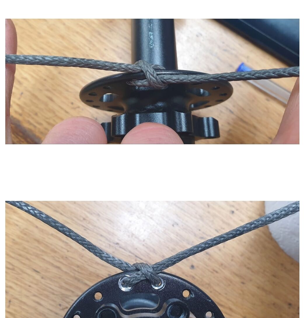

With a double length rope spoke you can do whatever you like and not infringe on Berd’s patent, but I was hoping to find a solution which still allowed the rope spokes to be removed from the hub without cutting the spokes. With ends glued on, you’d have to destroy the spokes to get them out of the hub.
The technique used in the video above would permit disassembly without destruction, but you would still have to disassemble the eye splices. Quite a bit of work making those back up again, and I suspect perhaps rather difficult to do with a tapered end?
