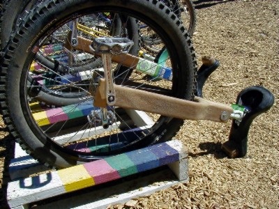

As someone without experience or equipment to do welding, I wondered how to create some kind of extended handle for my 36er, as others seem to do.
I think Joe’s comment about broomsticks was what I needed after lots of hacksawing and attempted bolting on of pieces of steel wheelchair from my trailer project. Metalwork without welding is just hard work.
So I came up with this:
It was first tried at the races in Warwick in September, where I managed to smash part of it by falling off. The design was rather an evolution, which explains the odd shape. I didn’t quite know how/if it would work, so I put the pieces together slightly oddly.
It works fine though! It weighs very little (broomsticks seem to be similar in weight to some very thin aluminium tubing I have (from window-washing poles) of a similar size, but much stronger/stiffer), and although a bit off-centre, it doesn’t actually rub. Possibly the nicest thing is that I can now see my speedometer (though still not wise to look down at speed).
Admittedly, it does go ‘creak’ a bit when under stress, and doesn’t put the brake lever in the ideal place. But it is unique and probably cost less than £3. :smiley:

you have a wooden seatpost!?
I can’t believe this thread is back… It’s from so long ago…
Anyways, it does look like it’s a wooden seatpost… thats odd, but kind of neat…

Sweet! Engineering breakthroughs like that just don’t show up every day. I think you need to pair your handle design with the Stoltzfus Wooden Muni for a true Flintstones riding experience.
That looks super heavy! That is pretty cool, cause me dad is good at woodworking.
I have a rusty seatpost. It’s the knurled 22mm one with my Quax 36 - ideal for attracting the rust in the pattern. I drilled through it with a standard drill bit - the slightly funny angle of the handle could be blamed on getting the holes a bit wonky.
