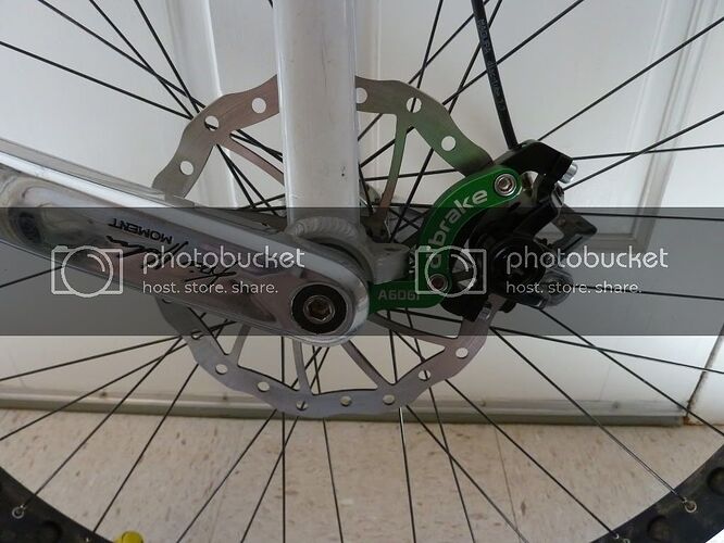

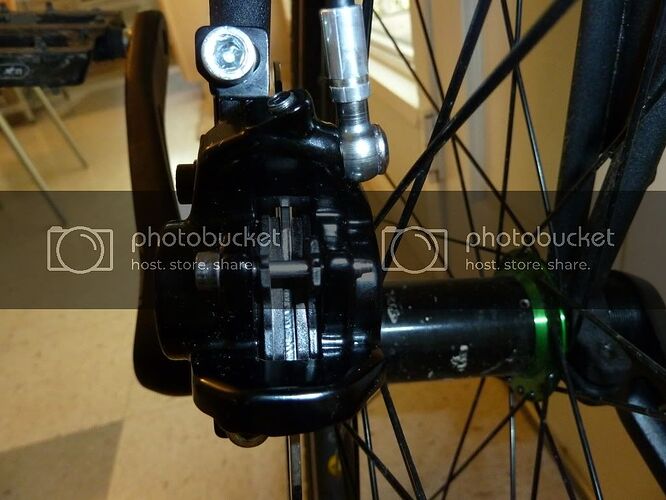

Here are some set up pics:
36er, D’ Brake, Magura MT2, 203mm Rotor-
29er, D’ Brake, Magura MT2, 180mm Rotor-
