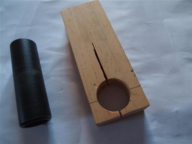

I cut my seat post this week using a hacksaw. What I did differently was how I held the tube in the vice.
  1. Get a piece of timber about 3-4" long, 1.5" wide, 0.5"-0.75" thick.
  2. Toward one end of the length of timber drill a hole through the piece the same diameter as your sea post.
  3. Using a saw, starting at the end nearest the hole, make a cut along the timber parallel to the long sides. You want to aim for the hole centre.
  4. You now have a saw cut finishing in the hole. By clamping this end of the timber in the vice the saw cut will be forced closed and the seat post will be firmly clamped by the timber without damage. You can now slowly turn the seat post as you make the hacksaw cut and your cut will be square and the finish neat.
    Get a file and chamfer the post end as you rotate the post within the timber clamp.
Added some photos to help explain previous post…
