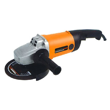

Angle grinders are relatively inexpensive and should leave a cleaner (no flare) cut. Be sure to wear safety glasses…tom
Fine for steel or cromo posts but grinders dont work so well on non feris metals. The disks kind of clog and dont cut as well.
Buy some decent blades and do it by hand, you can get it straighter cut with a hack saw than a grinder aswell.
