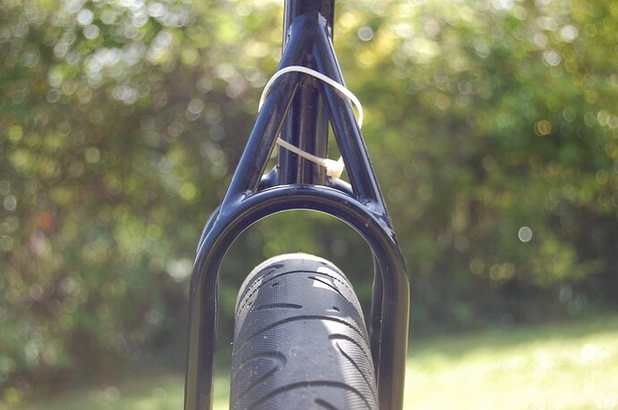

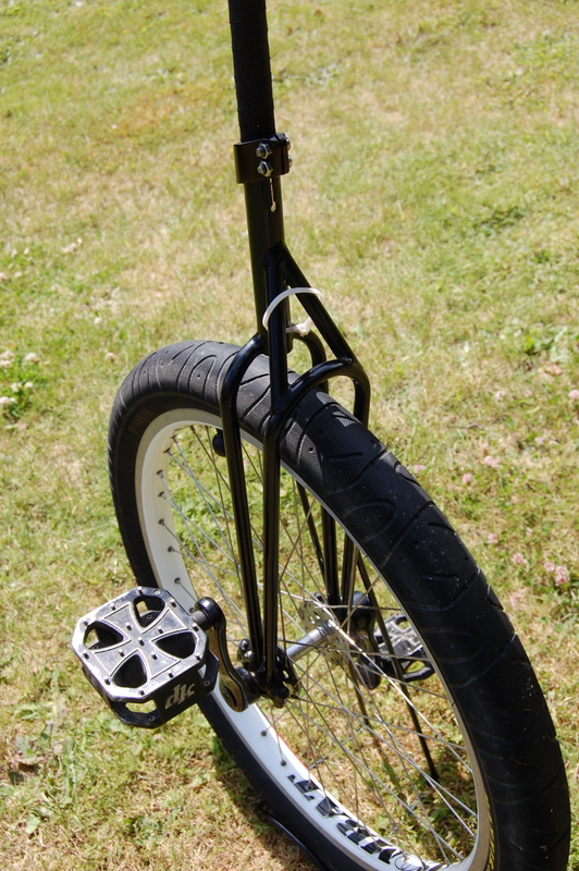

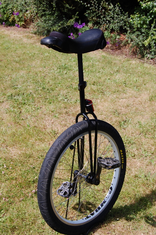

For those that don’t know, these were hand made by Joe Rowing in England. He stopped making them a few years ago, and I think mine might be the last 24" one he made.

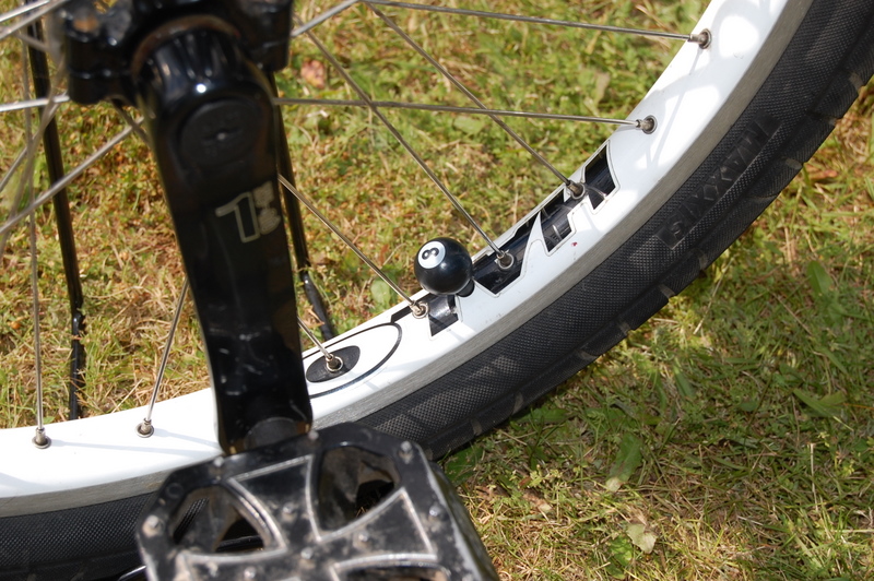

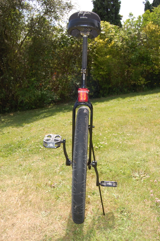

Mine is fitted out with a Suze hub, Halo Combat rim, Hookworm tyre, 127mm Qu-Ax cranks and DK Iron Cross pedals (Officially the worlds heaviest pedals ever… but also the coolest!). The top end is a Miyata seatpost (covered in black hockey tape), a carbon fibre seat base, a combination of Miyata and KH saddle foam, a KH Fusion seat cover and Miyata bumper & handle. Oh, and the obligatory 8 ball valve cap :slight_smile: The frame also makes an excellent mount for the removable rear light too.
It’s a fantastic uni for just cruising around, and also getting quickly and safely to the pub and back.

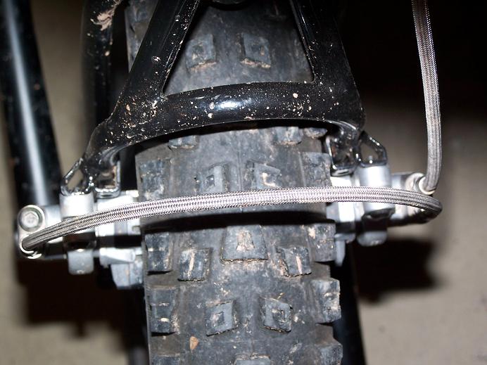

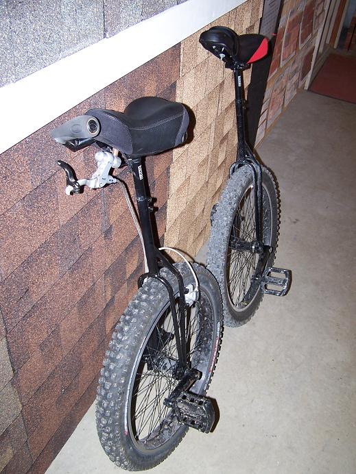

Here’s a couple. Notice the double brake mount for either a standard rim or a Large Marge.
Cool, that double mount is brilliant! I love simple solutions like that.

I’ve actually been contemplating selling the one in the picture that doesn’t have brake mounts.
Let me know if your interested. I’d be selling the complete uni though.
I can’t take the credit for the brilliance. Pete Perron did the brake mounts.

Do you think it could be possible to buy the Magura mounts on UDC and weld them so a Large Marge rim would fit? and have the 4 brake mounts like yours on the frame?
yeah, id be definatly interested, depending on the price, but i couldnt buy it right now (probably not till closeer to the end of winter), so dont feel rushed to make a desision, but definatly let me know if you are going to sell it.
That’s exactly what Pete did (he may only have welded on the second pair). I’m not sure if the first set was done by Joe.
