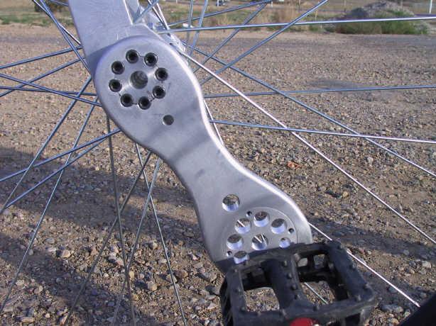

The best adjustable cranks I’ve seen are Bronson Silva’s rotational crank. You dialup the lenght you want than screw it down. I don’t have a photo sorry.
But here it is:

Nathan Hoover had a different design of adjustable cranks when he came to NZ for the Moonride. From memory the part of the crank near the axle was a square sleeve inside which the inner adjustable part of the crank slid. They could be adjusted to multiple lengths, but its weak point was that the inner sliding part of the crank was held in place by little set screws which would get shaken loose. At least thats what happened when ridden offroad.
daVinci Adjustable Cranks 170/150/130
I have been enjoying daVinci Adjustable Cranks 170/150/130 for over 6 months now with perfect success. They seem very well made.
I ride them on my Coker, mostly on pavement. Changing effective crank length is easy: use a pedal wrench to remove and reinstall the pedals in a different set of holes. Then adjust seat height and away you go.
