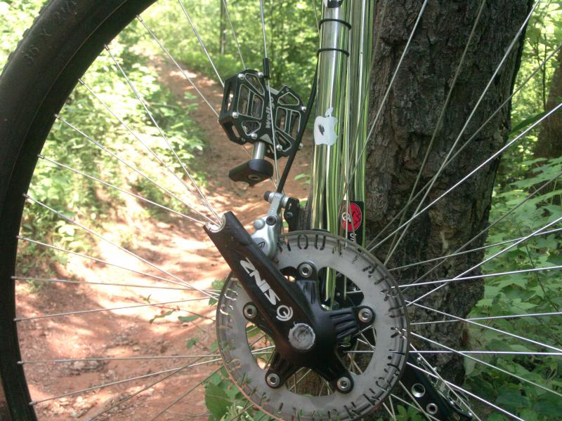

I have a new generation Coker wheelset, in a Nimbus Titan frame, with the T7 handlebar, and the Mountainuni disc brake rotor with Sinz cranks and an Avid Juicy 5 hydraulic brake. It’s perfect. The Mountainuni rotor inspires a lot of confidence when attacking steep downhills.
It used to be that at around 14mph I could feel that “I think I’m starting to spin a little too fast feeling…what if I had to slow down in the middle of this downhill ???”. Then I would start to slowly apply the backpressure on the pedals before I went any faster. Now, I just go for it, knowing I can begin to lightly apply that sweet disc brake if I can’t maintain the spin.

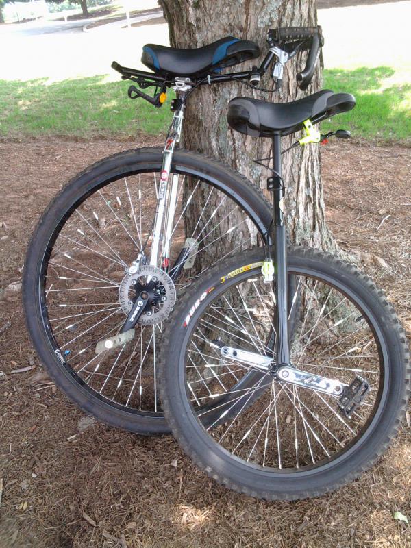

My max speed of 20.7 mph was attained about two weeks ago, heading down a steep hill with the pedals in the 125mm position on my Sinz 125/150 cranks (now deceased - see picture). My new cranks are Sinz 140’s. I seriously thank God that the crank didn’t snap when I was going that speed down the highway :slight_smile: They broke a few days later climbing a hill doing some mountain bike trails.
So anyway, if anyone else has Sinz cranks that have been drilled aftermarket, I would just be careful and keep an eye on them, or better yet, make a small compromise and just pick one size. Having a crank arm break on you is scary. I’m glad I didn’t break any bones!
The second pic is of the 36er with the new Sinz 140’s, and a new Coker button tread tire (I wore out the Nightrider tire - did too many 180’s without doing enough tire rotations to spread out the wear).
Also in the pic is my new Nimbus 26er with: Kris Holm seat and dual-holed Moments, and Magura HS33 brakes from Brycer1968. Just got the brakes on today, and they worked great on the trails. Thanks for the quick turn-around time and customer service Brycer! The neon yellow looks great with the black frame too :sunglasses:
Rhino, Glad to hear that the SINZ dual hole failed in an area that wasn’t catastrophic for you. We’re not abandoning the multi-hole idea, but we definitely are not drilling/tapping the SINZ beyond the one that’s cast specifically for the crank size. And TY for the nice endorsement for Mountainuni Disc Brakes and it’s inspiriing Big Wheel confidence!
