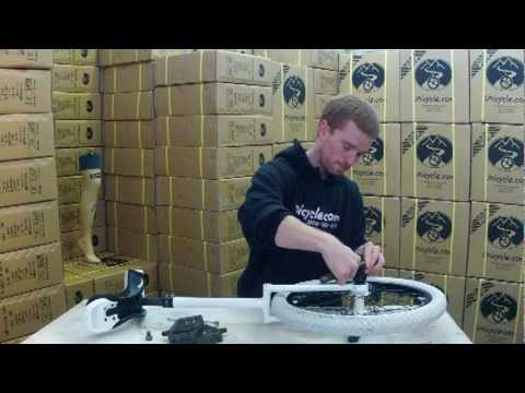

If they are ISIS cranks you may be able to use a thinner spacer washer to tighten the cranks. Spacer washers of different thicknesses are available from UDC.
The standard instruction for determining the required spacer thickness is to push the crank on by hand and then select a spacer about 3 to 5mm less then the space from the bearing to the crank. With the correct spacer the crank will fit tight on the tapered ISIS spline and against the bearing when the attaching crank bolt is tightened.
I’ve always gone with 2-3mm. 5mm would cause unnecessary wear to the crank interface (as tends to happen to cranks when installed on the older Schlumpf hubs that don’t have crank stops).
UDC UK previously said 3mm in their video:
