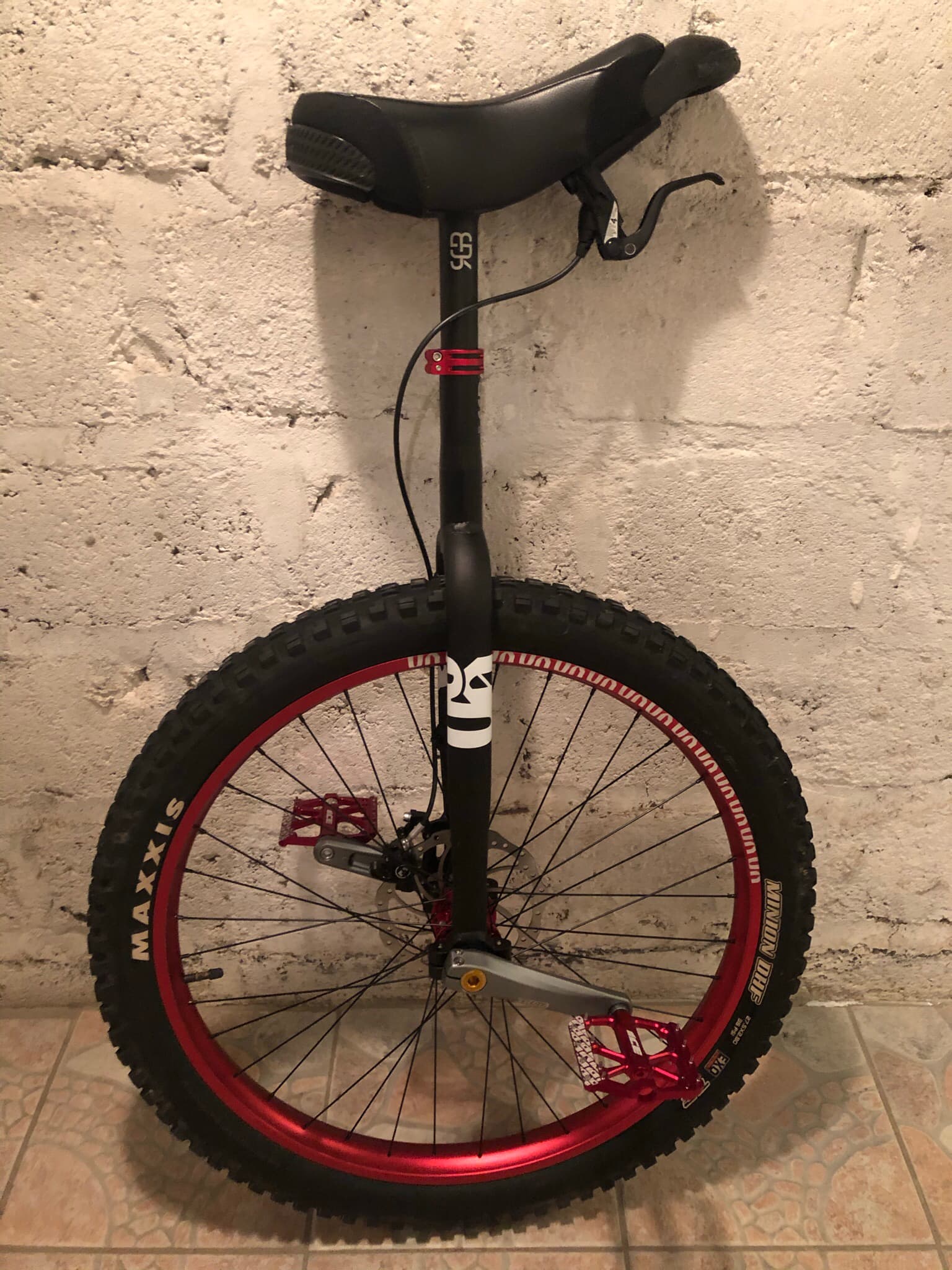

Lately I’ve come to prefer my 24" muni to my 27.5 quax rgb, so I’m thinking I’ll do some experimenting with fatter tires to see how I like them. With a 27.5x3 High Roller 2 on the wheel right now I have about 1/2 inch of clearance between the tire and the sides of the frame. So I think I can safely go as wide as 3.6". 3.8" or 4" might be possible, but would be pushing my luck. Quax rates the rgb frame for a maximum width of 3.25", but that obviously leaves some extra clearance.
If you’ve ever run a fatter tire on a quax rgb, how did it go? Also if you’ve had any experience, good or bad, with 27.5" tires between 3.25 and 3.8 inches what were they?

I think I’m going to give up on this idea. After looking into it, it seems that there aren’t many, (if any), options between 3.25" and 3.8". Panaracer makes a 27.5x3.5, but reviews say the actual width is approximately 3". There’s the Duro Crux 27.5x3.25 which by most accounts is a good tire, but I’m not sure it’s worth it to only gain 1/4". The Maxxis FBR 27.5x3.8 is right on the borderline of what could fit, but I don’t want to spend $120 only to find it won’t fit or that the rim needs to be perfectly tuned to avoid rubbing.

The more I read, the more I suspect the FBR 3.8 would fit too. Ive read reviews where people report it measuring 3.75” on an 80mm rim, but an rgb has a smaller rim than that. One thing I do wonder about though is whether frame flex might cause it to rub. IMO, it’s not worth the risk to find out.

you can use the ETRTO measure as a guide. It’s never quite true. The Maxxis Minion FBR has an ETRTO dimension of 97-584. So you can count on a width of 97mm (it is never exactly correct and is usually a little less, probably also depends on the rim width used). You still have to have reserve left and right, as the tire moves in the frame under load (climbing a mountain). I suspect that the RGB frame is too small. You can ask qu-ax how the dimensions are inside. I guess it’s around 95mm
