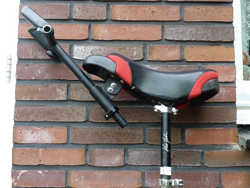

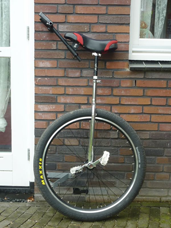

Since many years I’ve had a Kris Holm Fusion Freeride saddle on my 29" distance unicycle.
When I bought it, the seat had one of the shallowest curves available at the time. But I think that the curve is still to deep for my liking.
See pictures for my current setup.

I have a carbon fibre base on my 36er saddle. It is flatter than the Freeride. When I first started riding it, I was fine with the flatter saddle but as soon as I got onto hills it didn’t work for me.
I eventually tilted up at the front right to the limit of the KH adjustable post. I have always relied on controlling the nose of the saddle between my legs when I get up out of the saddle. I couldn’t get the same stability with the nose lower.
I use KH short bars and I suppose I could control more though them but that would mean require more lateral force through my upper body.
You could experiment by flattering your Freeride. There are several threads on this site about doing it with hot water.

Also what length cranks are those on the 29er?

102 mm. I ride in a flat area, and am training for the marathon and 100 km races at Unicon in Korea which are also more or less flat.
