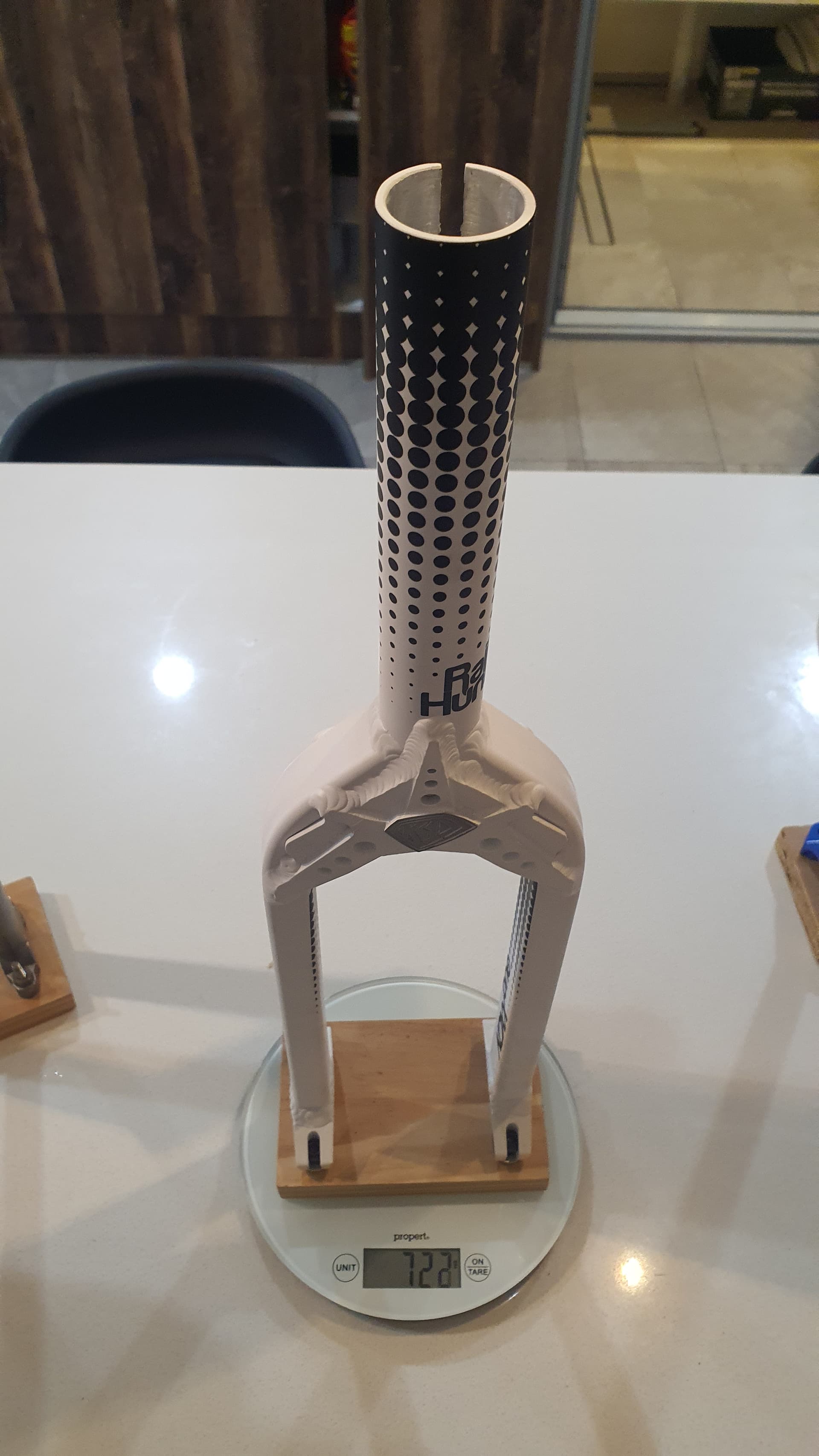

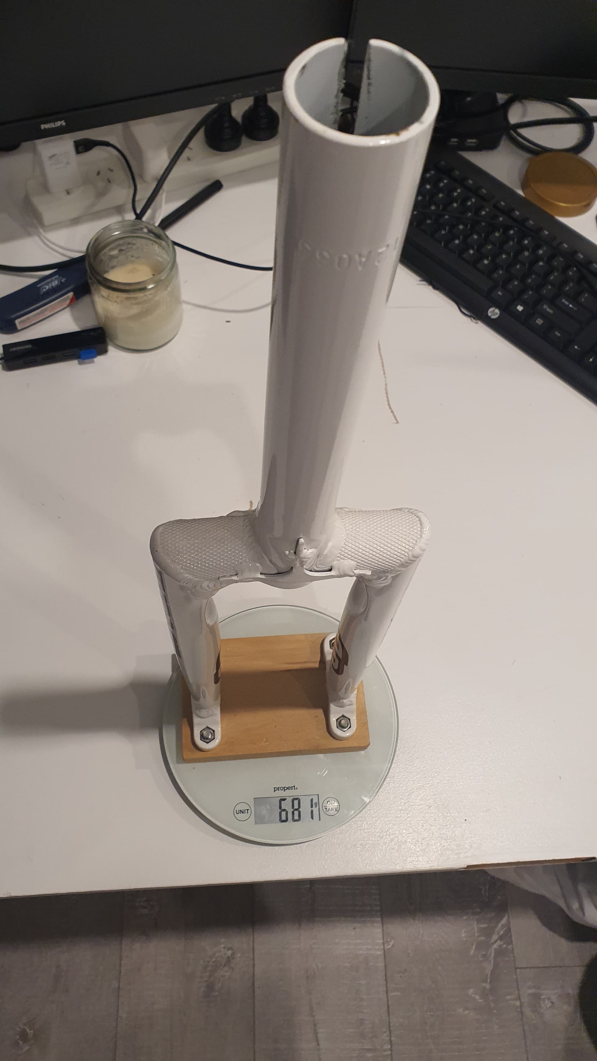

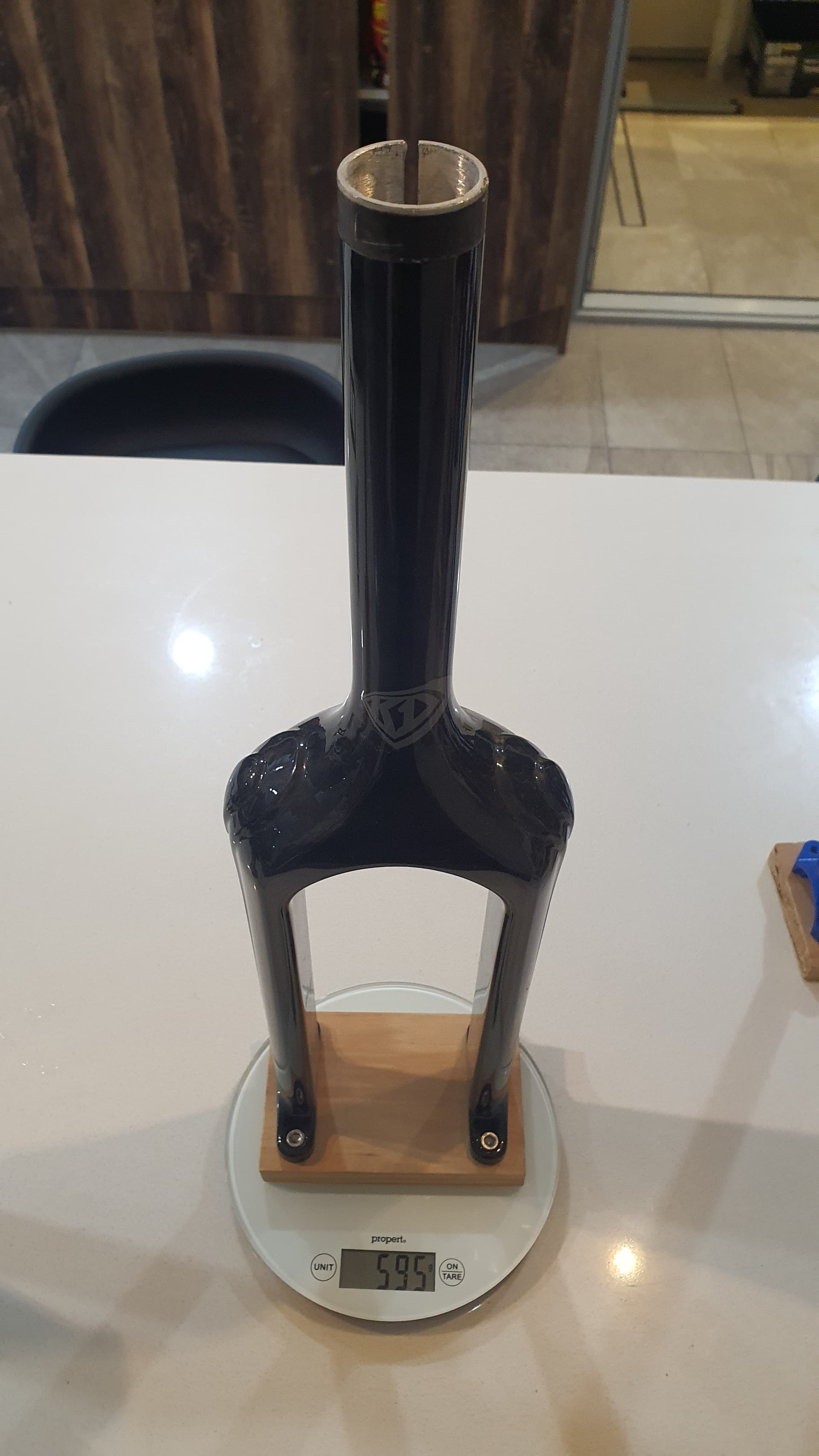

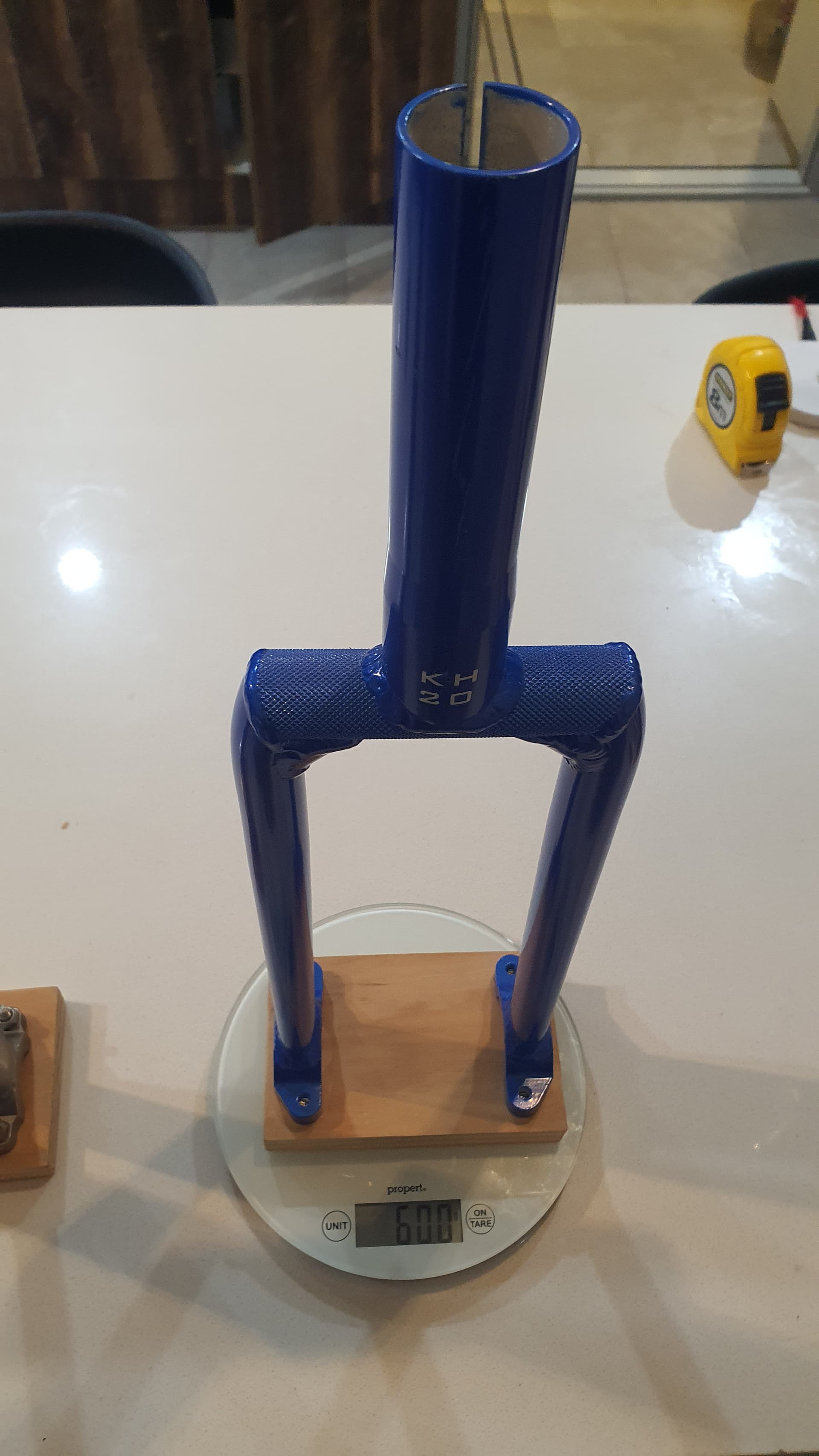

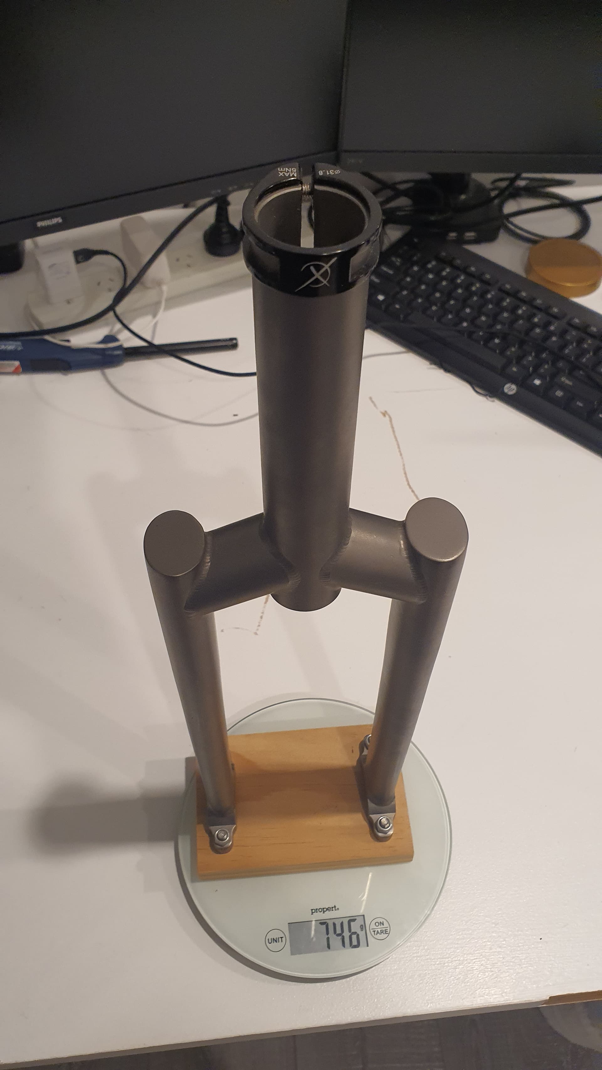

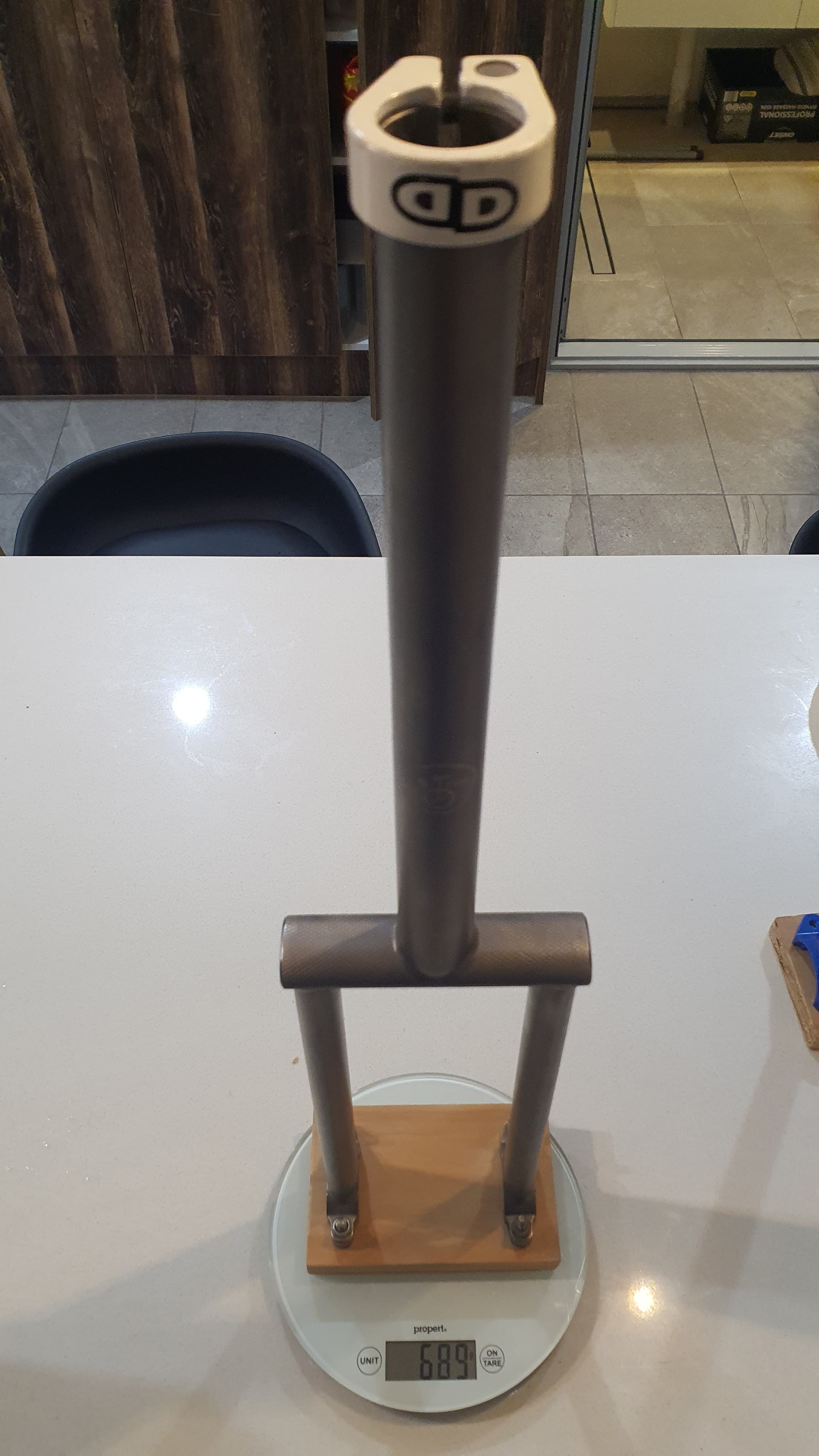

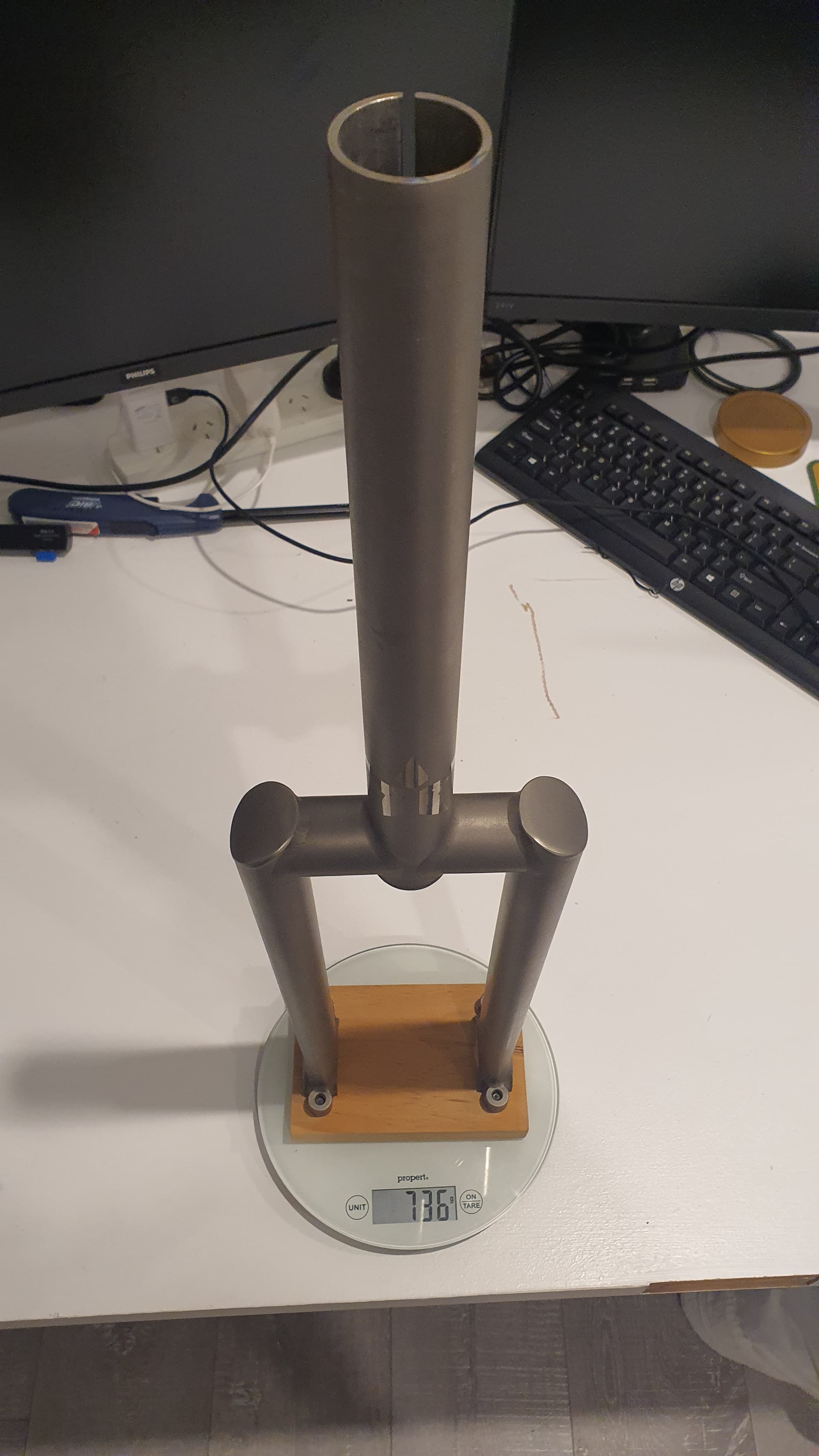

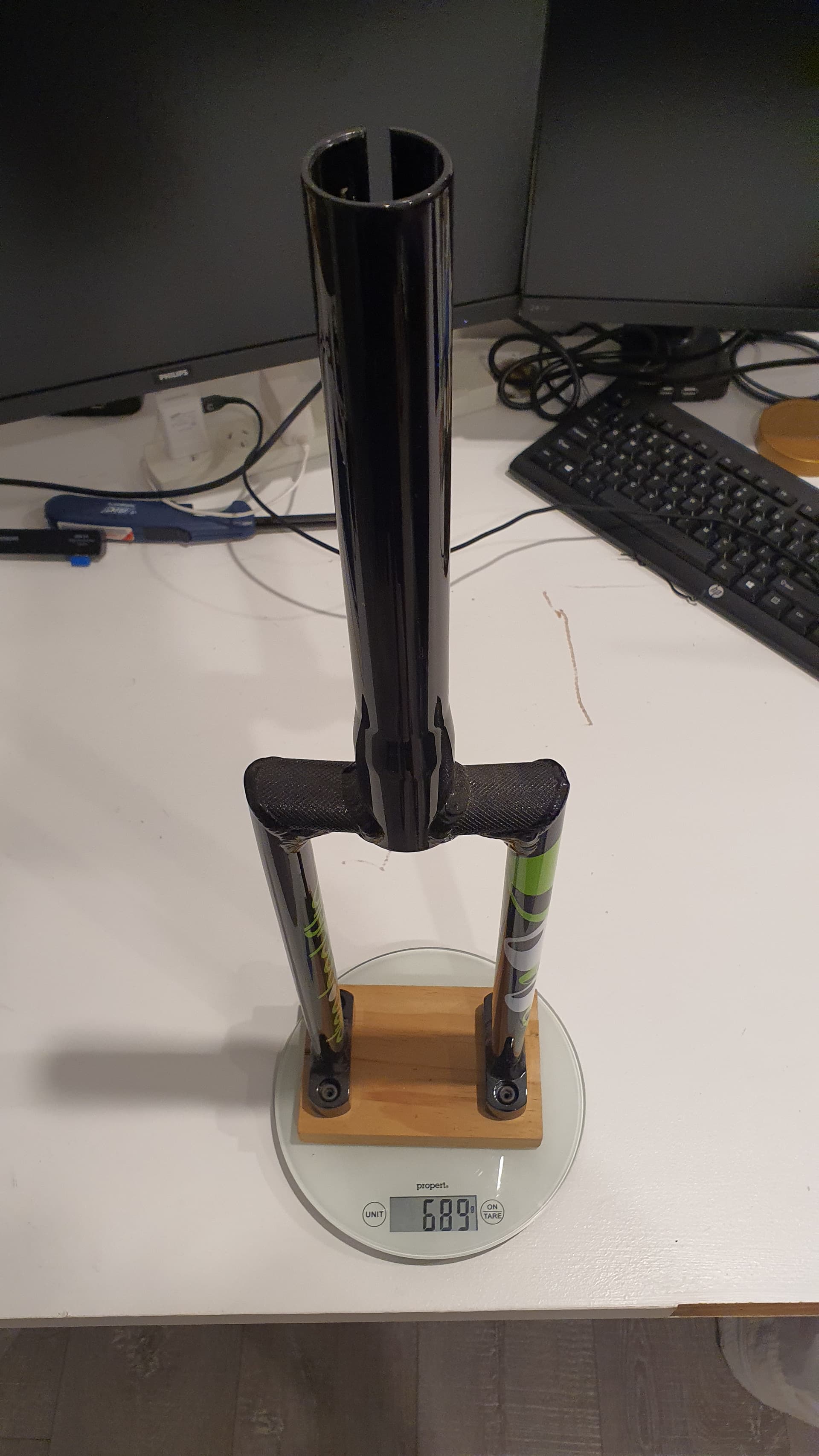

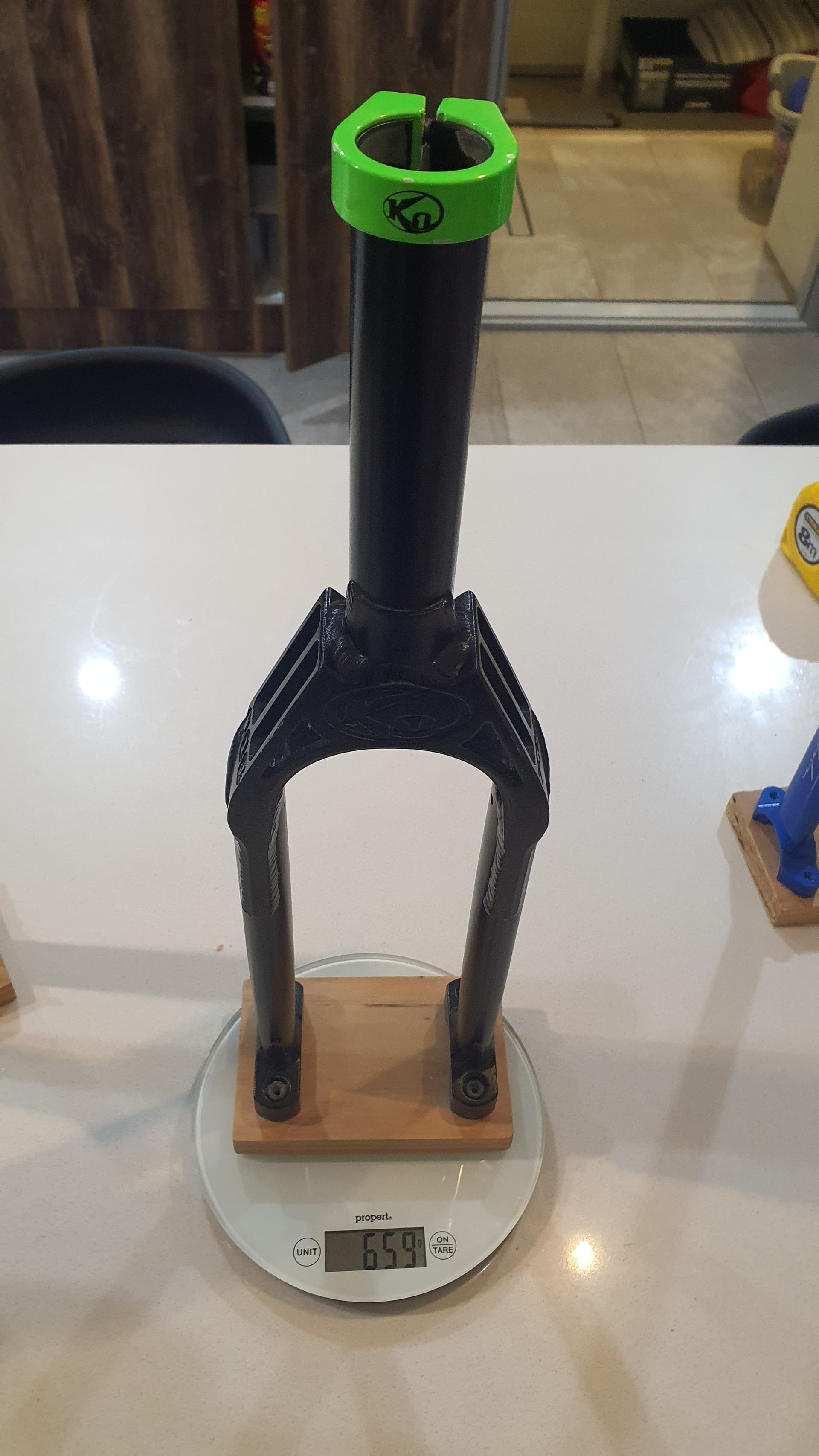

For example a KH or Nimbus 29" frame is 500-650g or so, and a carbon fork for a fat bike are about the same weight.

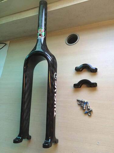

Indeed @rogeratunicycledotcom made some in 1997 or 1998? I am sure he could confirm and say why their are no carbon Nimbus frames. In addition IIRC @johnfoss has one.
The Mk1 and Mk2 carbon frames were made in 1996. John has a Mk5 carbon frame of which there were 20 made, some of which are still being used.
They are lovely frames, just don’t fit modern hubs and tyres.

Sounds like Finnspin has the most accurate short answer to that question. Yes, I have a Roger Davies carbon frame that was probably made in 1997. Three examples of his frame were also present at the world’s first Mountain Unicycle Weekend (Auburn, CA 1996). Roger, Constance Cotter and Andy Cotter all had them at the time. This page inculdes a (tiny) photo of them.
They were made with very sturdy (thick walled) carbon tubes, using machined aluminum lugs for the bearing holders, crown and probably where the seat clamp attached. Simple design, extremely light and very strong. The only downside I can think of in that particular design was that the round tubing would make a wider frame than many people would want. And this was before Mountain Unicycling started using 3" tires; they wouldn’t fit them later on, which is why my beautiful carbon frame hangs in the garage and is rarely seen on a trail, it only fits tires up to about 2".

The Karbon Koncept carbon frame was still lighter than available aluminium and titanium frames at the time, the KH shortneck was close but has a reasonably shorter neck.
Maybe the Nimbus titanium could be lighter with a similar sized neck?
Potentially the new impact gravity or the hydroformed impact gravity could be lighter, but I am unsure.
The difference in weight in comparison to the lightest aluminium frames is still small so I am guessing most would prefer not to sacrifice durability for 10 or 20 grams. That would make the market pretty small.

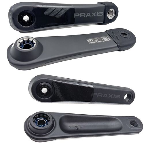

For fun I found some carbon 160 mm carbon ebike cranks online too. They similar in my mind to my VCX cranks. So apparently our current stuff is not too bad and there’s good reason to stick with aluminum
100%, the main usage case would probably be trials but I’d struggle to trust a carbon fibre frame that has fallen off a high pallet and hit things on the way down
How do carbon cranks weigh more than similar length vcx cranks? VCX aren’t exactly made for weight weenies.
375g for 160
Vcx 100/125/150 are about 450g for the one I ride
The 165 VCX are about 475
The cheap aluminum Qu-Ax one say they are about 245g for a 100mm so quick math makes my estimate for a hypothetical 160 maybe 392g or so.
