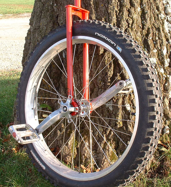

To answer the OPs original question (even though it’s been fairly thoroughly answered already), Yes. And here’s a photo of the kind of thing you’ll end up with;
STM
Thanks for the photo. A picture is worth a thousand words! I don’t think the spider would cause any problems, would it?

I don’t see that it should cause any problems. Even with a chain ring on it, it doesn’t affect bike riders. Having said that, though, I haven’t ridden a unicycle with one* so can’t offer any guarantees… but as mentioned earlier, you can always take a hacksaw to it.
