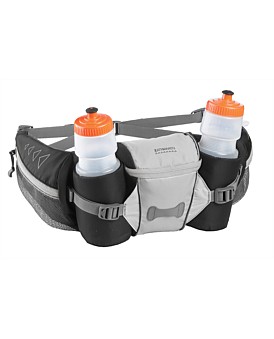

I don’t like the idea of drinking from a plastic bladder, and those things are high maintenance, so have just bought this cool pack that runners use. Go to the Kathmandu website and look under active packs. It’s called a v twin bottle belt. (the bottles face towards the back - looks more elegant than a “moonbag”) Perhaps you get can one on-line or source something similar locally. I like it cause it also solves wallet/keys/snacks storage on long rides and is very easy to use.
