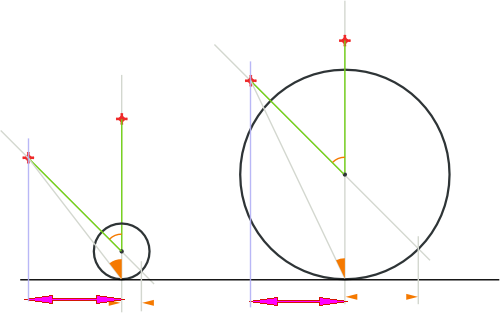

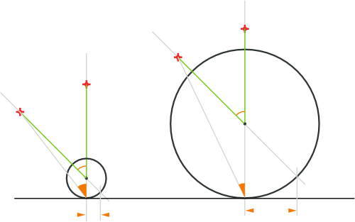

Let me clarify what I meant by point of contact:
When you are upright on the unicycle, extending a straight line from the frame to the ground puts you very close to the wheel’s contact point with the ground. Now lean forward so the frame is 45 degrees. Extending a line from the frame to the ground now lands nowhere near the contact point.
In relation to the frame and rider, the contact point with the ground has moved forward. If you do the same experiment with a very small, you’d find the contact point is very close to the same no matter what angle you lean.
I’m not going to argue about the stored energy - can’t be bothered to work it out, so I’m prepared to be proved wrong.
But I really don’t agree with the contact patch thing - what’s a line drawn through the frame to the ground got to do with it? Gravity doesn’t work in the direction the frame’s pointing. If you fall forwards, your centre of gravity is in front of the axle, so in front of the contact point with the ground. The contact point has actually moved back relative to the rider. The size of the wheel has nothing to do with this apart from putting the rider’s c of g higher on a larger wheel, which is in theory easier to balance (same as it’s easier to balance a long rod on your hand than a short one).

    Rob: the attached diagram should clarify what I’m trying to say regarding the contact point. Since the wheel is round, leaning the frame forward means the contact point is somewhere in front of the frame (still directly below the axel). This has everything to do with balance, because the centre of mass shifts a smaller angle from the contact point for a given frame angle on a larger wheel.
    The centre of mass still moves the same distance ahead of the contact point for a given angle.

    I know what you meant - I just don’t agree with you.
    No! You can’t rotate gravity to suit yourself.
    But you’ve drawn the angles on yourself with the orange arcs (between the leaning frame and the vertical) - they’re identical. I don’t reckon the “angle at the contact patch” (solid orange) is relevant at all. All you can do to control balance is ride the wheel forwards, which moves the axle forwards. The height of the axle makes no difference to this does it? The length of the frame (and therefore the height of the rider above the axle, not the ground), will affect balance (like on a giraffe), but I’m utterly convinced the height of the axle (which is the only thing the wheel size affects if we’re ignoring gearing and assuming the smaller wheel is geared up to the same ratio as the big one) has no effect on this scenario.
    Yes, and this is what matters, surely. (the pink arrows I’ve added to your diagram).
    Rob
