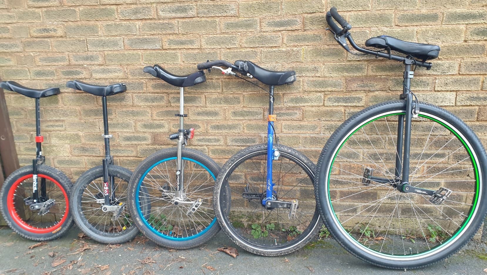

Short version: How would you cut this lot down to 2 or 3 unicycles for a fairly risk averse guy who’s about to have less space to store but hopefully more time to ride? 19", 20", 24", 26" & 36" (the 26" has a geared hub and can also run a fatter muni tyre):
Long version: I’m soon moving to a place with little storage space, but I’ll hopefully have more time to ride and maybe even learn some stuff - I currently just ride forwards to get places, often pulled or hindered by our dog! I’m looking to cut down on unicycles but allow for future flexibility of use. Any new stuff I learn is unlikely to be pushing the risk boundaries as I’m 56 and also carer for my wife who needs me fit enough to push her wheelchair, etc.
My current unis, in order of preference for keeping:
  • 26" guni, 129mm cranks (or 148 or 110), 2.1" gravel tyre (currently - or 2.8" / 3" muni tyre) - in high gear it’s equivalent of a 40" wheel, but not relaxing for me to ride like that
  • 24" all-rounder, 113mm cotterless cranks, flexible 2.3" tyre, not valuable so good for errands / shops etc, spins quite fast, would be even faster with 100mm cranks
  • 36" KH, 137mm cranks, with ShadowHandle - used less, but offers faster speeds and longer rides in a relaxed way, and you can’t beat the visual impact of the big wheel!
    === probably should keep 3 max
  • 19" trials, 125mm cranks - got it with a view to ‘learning stuff’ but barely used it. Better quality than my 20"
  • 20" freestyle, 100mm ISIS cranks - Indy frame and wheel with upgraded cranks, tyre and seat, learned to spin fast with this when our dog was smaller, still fun to do sometimes but lacks speed
    === already gone
  • 20" 5ft giraffe (never even rode it!)
I guess my indecision is around whether I ‘need’ a 36er given that I have a g26, and whether I’ll regret getting rid of the small wheel option (but will I really ever do trials or freestyle??)
