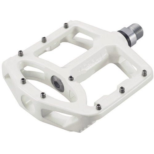

DMR V12’s are very good pedels for what they cost, get the chromed version because it doesn’t chip while the anodized paint wears of and is chipped of, personally i do not like mag bodies on peddles because it is dented and cracked easily.
the DMR V8’s are great if your limited by money, and have a great way of re greasing the baring’s, just inject fresh grease in through a hole in the body, and it pushes the old grease out of the seals.
they look nice but at 536g, they are much heavier than I want to go.

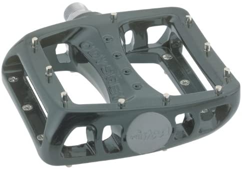

Animals and Odyssey Twisted PC are ~400gms. I wouldn’t mind having these pedals with a lighter spindle, but I think they’re designed as disposable being as the bearing are not sealed and the pins are no replaceable.

http://www.amazon.com/Odyssey-Twisted-Pro-Pedals-Silver/dp/B000VT3ZNY
(metal) for MUni. These things really take A LOT of punishment and keep on working. I’ve had them on my KH24 for over 4 years now and they are still going strong. Sure they’re a bit heavier and the metal pins may be “dangerous”, but they last forever and provide awesome grip. Perhaps I’ll try some nylon/metal pedals when these things die. I wear the leg armor for more reasons than just pedal bites so really no need to change my style.

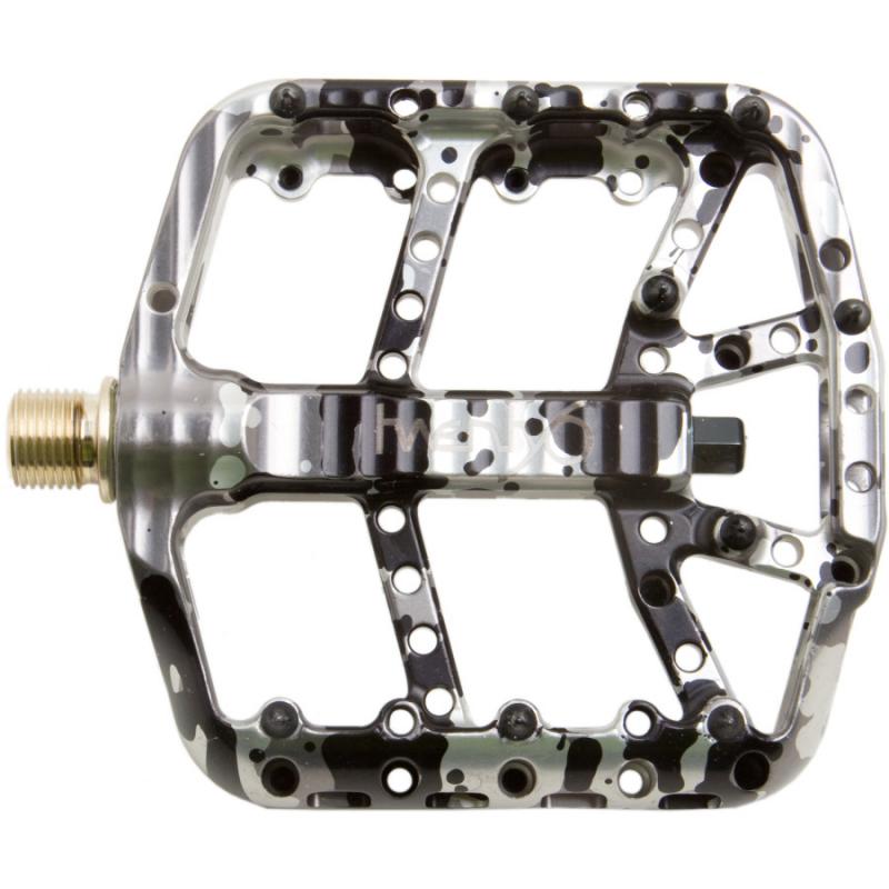

If money is no object, THESE are the most awesome pedals I’ve seen yet! only 265g for the pair and super wide foot area. Sealed bearing never need lubrication. Watch the video about them at the lower part of the page. I might just get a pair…but not at Sears! They sell them for $432 a pair! :astonished:

@MuniAddict: I thought about buying the Twenty6 pedals but when I saw them IRL the platform area was smaller than most of the other DH style pedals. The pair I saw were not the current model so they might have changed. Just something to be aware of.

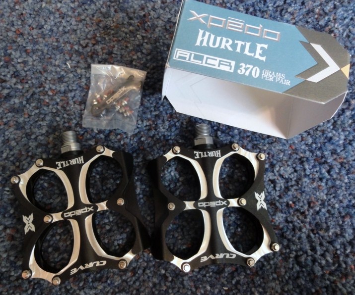

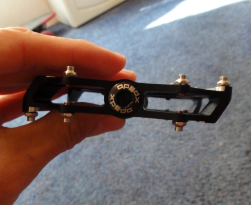

Just got another new pair of pedals, in addition to my new wellgo MG-1’s that I really like. These new (sealed bearings) pedals are Xpedo Hurtles and they’re super grippy, light, thin and have a nice wide foot area. I also like the look. :slight_smile:
that is super sick!!!
