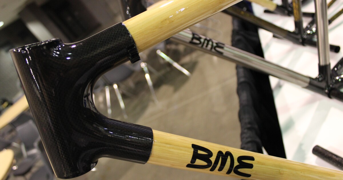

Bamboo frames have been discussed here before, and the consenus, I think, was that bamboo lacked the stiffness needed for a uni frame. Unlike a bike, a uni is subjected to all sorts of rotational force when we pedal, or so it was written in some dark corner of this forum. Apparently UDC was even going to start production at some bamboo bike frame company in Taiwan, but then decided it wasn’t feasible.
This pdf shows that a bamboo unicycle has already been made…Looks like a sweet uni :slight_smile:
For the challenge thing… So we have to make it or discuss? I’d be happier to make it haha :stuck_out_tongue: I’ll check out for Bamboo online :wink:
It certainly would be amazing to find that bamboo is a superior frame material. Aluminum is pretty darn perfect.
I just saw this article while looking for Bamboo tubings on the web. I still haven’t found any tubings except for a whole bike tubeset. We’d only need chainstays/seatstays and seattube. I’m still checking, I am motivated for that :slight_smile:
Yeah, that’s the story I was referring to above. With the admittedly very pretty photos, it says “This as a feasible design that could be mass produced is unlikely. The bamboo itself has a lot of flex and would likely break because of the torque the frame receives during normal riding.”

A “bamboo” uni can be made very stiff, in the same way that Calfee makes its bamboo bikes; by turning it into a composite. At that point it basically behaves like carbon fiber, and you can use carbon fiber for the joints. It’d certainly be cool. Not so cool that I’ll fund someone else’s commercial R&D, though.

Calfee does make some pretty cool bikes (they’re the first rest stop on the annual Strawberry Fields Forever bike/uni event). You would have to use a lot of composite and carbon fiber though, which might take away from the bamboo-ness of it.
